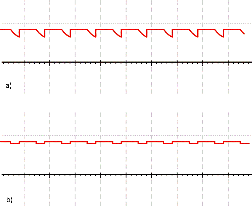

Figure 2. VLED+ without capacitor C2 has ripple (a); VLED+ with capacitor C2 has reduced ripple (b).
In the circuit, 12 0.5 W LEDs operate at 120-mA dc (135-mA RMS) with respect to current-sensing resistors R3 and R4, chosen as 1 Ohm. You can, however, increase the number of LEDs to 18 as long as the voltage being applied across the string is more than the sum of the forward voltage of the individual LEDs. (White LEDs’ forward voltage varies from 3.3 to 4 V.) The voltage appearing across the string is self-limiting (in this case, it is around 42 V) and does not require any additional regulation, since series-connected LEDs behave like high-power zener diodes when operated in forward-biased mode. The circuit draws 11.5 W power at 230 V ac RMS and exhibits a power factor of 0.93 without any perceptible flicker in the LEDs. You may optionally connect a 220-uF capacitor, C2, between VLED+ and V LED GND to further suppress ripple, as shown in Figure 2. Alternatively, the given string can be replaced by six parallel-connected strings of LEDs, each having 12 to 18 20-mA rated high-brightness LEDs. You must mount transistors Q1 and Q2 on heat sinks to avoid thermal runaway.
