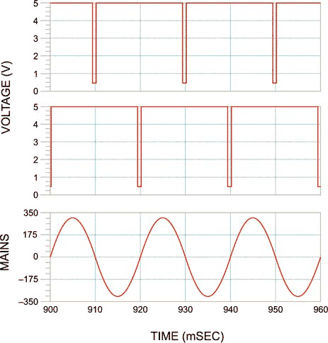

The circuit shown in Figure 1 provides two separate and optically isolated outputs, ISO1 and ISO2, for synchronization with the desired half-period of the mains. Figure 2 shows the results of simulation (using the free version of TINA-TI). The circuit accepts mains input from 80V ac to 240V ac, and consumes less than a milliamp of current.

Figure 2. Simulation results demonstrate the circuit action.
The duration of the pulses at outputs ISO1 and ISO2 is less than a millisecond, and capacitor C1 can be adjusted to achieve the exact alignment of the falling edges of outputs ISO1 and ISO2 with the zero crossing of the mains. All diodes, D1 to D5, are small-signal type 1N4148 or similar.
