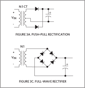

So how do you set output voltages? Unlike regulated DC-to-DC architectures, the MAX13256 always drives the transformer with a 50% duty cycle square wave. Consequently, output voltages depend on transformer winding turns ratios. So, care must be taken to select or specify an appropriate transformer for each application.

MAX13256 secondary rectifier topologies
