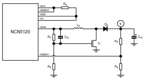

NCN5120 has several voltage regulators to generate different voltages. One of these voltage regulators is a 20 V low drop linear regulator typically used for driving relays. Because NCN5120 has a high efficient adjustable DC-DC converter, driving of relays can be done in a more efficient way. This application note describes how to use the adjustable DC-DC converter for driving relays in an efficient way under all operating conditions.

DC2 Schematic for Driving Relays
