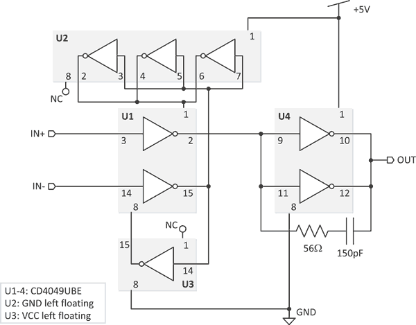

Ever-increasing demand for smaller, more efficient CPUs has driven CMOS fabrication deep into the nanometer scale. The supply scaling and device leakage of these fine processes adversely affects precision analog circuits, leading researchers to find highly-digital alternative architectures for traditionally analog-intensive functions [1, 2]. This “digitization” of the analog domain will eventually trickle down to the home hobbyist, who will face increasing difficulty finding simple analog components. This frightening trend was foreshadowed in 1973 by a Fairchild Semiconductor application note [3]; however, none of the examples given for op-amp-like circuits provide differential inputs. This Design Idea attempts to fill this void, demonstrating a two-stage op-amp with true differential inputs and near rail-rail output swing, operating from a single 5 V supply.
Figure 1 shows the complete implementation of a two-stage op-amp using only four CD4049UBE [4] hex inverters, a resistor, and a capacitor. Note that pin 8 of U2 (Gnd) is left floating, while pin 1 of U3 (VCC) is left floating. The output of the parallel inverters in U2 is connected to the VCC pin of U1, while the output of the inverter in U3 is connected to the Gnd pin of U1.

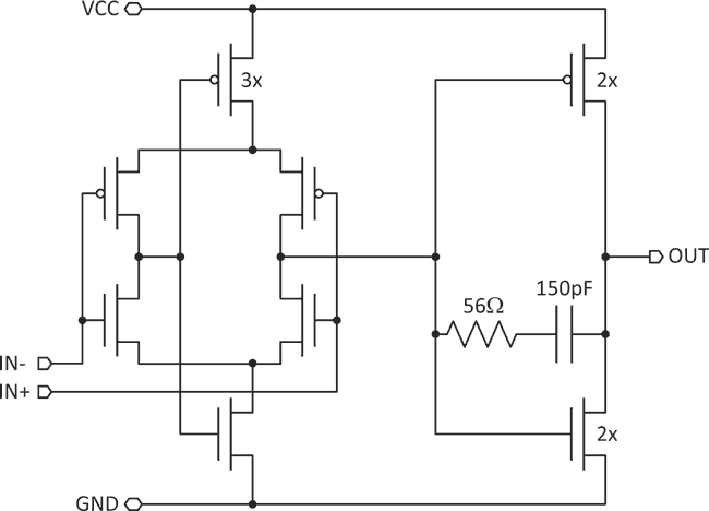

Figure 2 shows the functional transistor-level schematic of the resulting circuit, with extraneous transistors removed. The first stage is a circuit taken from [5], and implements the differential-to-single-ended conversion. The PMOS devices from the inverters in U2 behave as current sources, while NMOS in the inverter from U3 is a current sink. Unequal numbers of sources and sinks were used to pull the common mode range near mid-scale, due to the unequal NMOS and PMOS strengths.
 A true op-amp made from inverters
Figure 2.
The inverters in U1 behave as a gm-doubled differential pair. Since the first stage only has between 25dB & 30dB of gain, a second stage is added. Standard compensation techniques are used to ensure overall stability, since both stages by themselves have similar bandwidths. Note that any reasonable feedback configuration forces the second stage into its linear range, obviating the need for a gain-reducing local shunt resistor.
