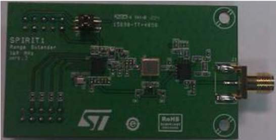

This application note outlines the expected performance when using the SPIRIT1 with a range extender under EN 300 220-1 (v2.3.1, 2012-02) in the 169.400 - 169.475 MHz band, meter reading, tracking and tracing applications. The maximum allowed output power in this sub-band is +27 dBm (500 mW), this application note relates to an application designed to reach the maximum permitted power, while respecting ETSI requirements.

SPIRIT1 with range extender application daughterboard
