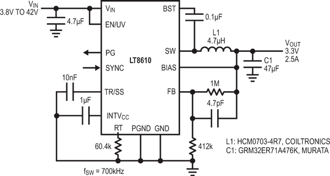

Figure 1. LT8610 12 V to 3.3 V Application Achieves High Efficiency.

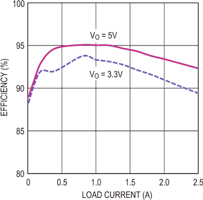

Replacing an external Schottky diode with an internal synchronous power switch not only minimizes the solution size, but also increases efficiency and reduces power dissipation. The efficiency improvement is significant in low output voltage applications where the voltage drop of the Schottky diode represents a relatively large portion of the output voltage. Figure 1 shows a 12 V to 3.3 V circuit. Figure 2 shows the efficiency of this circuit reaching 94%, which is 5% to 10% higher than a comparable nonsynchronous circuit.
Design Notes: 42 V 2.5 A Synchronous Step-Down Regulator with 2.5 μA Quiescent Current
Figure 2. Efficiency of the 12 V to 3.3 V Application (Circuit Shown in Figure 1).

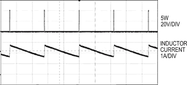

The LT8611 current sense and monitoring functionality may be used to limit short-circuit current or to create constant-current, constant-voltage (CCCV) supplies. Figure 3 shows well controlled current during a short-circuit event. The LT8611 can also be combined with a microcontroller with A/D and D/A to create sophisticated power systems. Typical apps include maximum power point tracking (MPPT) for solar charging and programmable LED current source.
Figure 3. Short-Circuit Current is Well Regulated at 42 V with the LT8611.

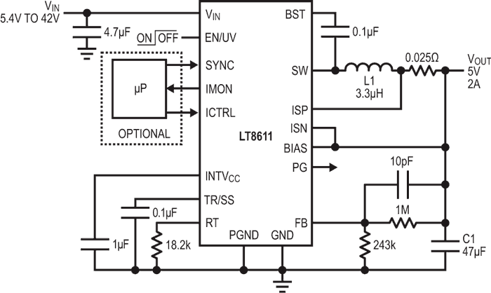

High switching frequencies, though, come with some trade-offs, including reduced ability to handle wide input voltage range commonly found in automotive and industrial environments. However, the LT8610 and LT8611 minimize these restrictions by allowing both high switching frequencies and high conversion ratios. This is due to their low minimum on-times (50 ns typical) and low dropout, resulting in a wide input range, even at 2 MHz. Figure 4 shows a 5 V, 2 A, 2 MHz circuit that can accept 5.4 V to 42 V inputs. The circuit has a 2 A output current limit.
Figure 4. LT8611 Running at 2 MHz Reduces Solution Size, Avoids AM Band, and Still Allows High Duty Cycle.

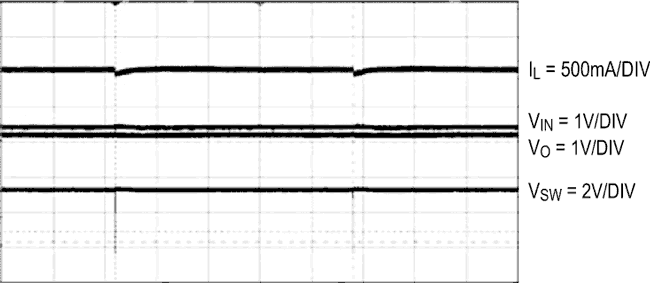

As the input voltage decreases toward the programmed output voltage, the LT8610 and LT8611 maintain regulation by skipping switch-off times and decreasing the switching frequency up to a maximum duty cycle of 99.8%. If the input voltage decreases further, the output voltage remains 450 mV below the input voltage (at 2 A load). The boost capacitor is charged during dropout conditions, maintaining high efficiency. Figure 5 shows the dropout performance.
Figure 5. LT8610/LT8611 Dropout Performance.
