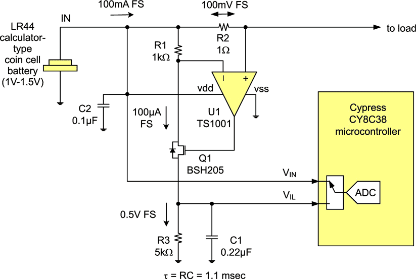

Current-sense amplifiers can monitor battery or solar cell currents, and are useful to estimate power capacity and remaining life. However, if the battery or solar source is a single cell, it’s difficult to find a low voltage solution that works below 1V and draws just microamps. A new class of nanopower analog ICs, namely the TS1001 0.8V/0.6µA op amp from Touchstone Semiconductor, makes a sub-1V supply current sense amplifier shown in Figure 1 possible. This discrete circuit operates from as low as 0.8V and draws 860nA at no load while providing a 0-500mV output for measured currents of 0-100mA, though the scale can be adjusted by changing the values of a few resistors. With its extremely low power, the circuit can simply remain «always on,» providing a continuously monitored, averaged indication of current which can subsequently be read periodically by a microcontroller, without causing too much current drain in the battery.
A New Class of Nanopower Analog ICs Enable Sub-1V, Micropower Current Sensing Techniques
Figure 1. A Low voltage current sense amplifier utilizing a nanopower op amp and low threshold P-channel MOSFET.
Among other things, the circuit can be used to estimate the impedance of a small coin-cell type alkaline battery to determine its condition, its ability to source power, and estimate its remaining life. Measuring the battery voltage (without knowing the load) generally provides only a crude estimate, and performing «pulse tests» as recommended by some battery manufacturers can be disruptive to the circuit the battery is powering.
The TS1001 is configured to servo P-channel MOSFET Q1 in a current source configuration, drawing current through R1 to compensate for the voltage drop across R2 caused by the current flow from IN to the load. R3 converts Q1’s drain current to a voltage and C1 provides filtering. The filtering is critical in allowing the current sense amplifier to continuously provide an averaged current output, enabling the microcontroller to sleep for long periods and save power, waking only periodically to read this mean current level.
The accuracy of the circuit is extremely good, generally limited only by the accuracy of the resistors used.

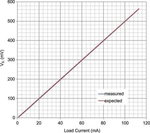

Amplifier input offset voltages need to be considered carefully in this circuit. The TS1001 op amp is specified with ±3mV maximum input offset voltage at 25°C, which corresponds to ±3mA of error. Figure 2 shows an offset of approximately 2.5mA. Another consideration is that Q1 exhibits drain-source leakage current of a few 10s of nanoamps at 25°C and can approach 1µA over the commercial temperature range. Since the current through Q1 is effectively controlled by the TS1001’s loop, any drain-source leakage from Q1 appears as a current floor and generates a corresponding minimum voltage output across R3 below which current cannot be measured until the op amp «takes over» at higher measured currents. Therefore, normal methods of removing the current sense amplifier input offset voltage by subtracting the zero-load voltage at VIN will not work, since the offset voltage due to the op amp’s VOS and the current floor from Q1’s drain-source leakage cannot be separated.

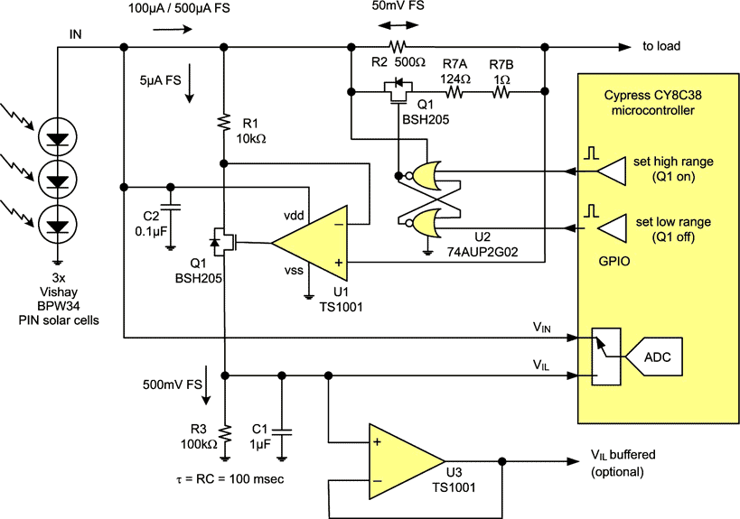

Figure 3 shows an alternative configuration which provides a means for calibrating out the amplifier offset voltage. The circuit is set up for measuring very low currents, in this case from 3 series-connected PIN solar cells. The circuit can be used as part of an energy harvesting system in a maximum-power-point-tracking (MPPT) scheme, where the microcontroller adjusts the loading of the cells to maximize V × I and yield the maximum available power.
The circuit works in a similar way to Figure 1, but it has been scaled for a selectable 100µA/500µA full scale current where the full-scale sensed voltage across R2 has been decreased to 50mV to improve efficiency. With this lower voltage, the ±3mV specified input offset voltage of the TS1001 causes up to a 6% offset error, which may be unacceptable.
This offset may be calibrated out using the principal of making two measurements of the same parameter at the two gain settings. The offset then can be found as:
where VIL_G1 and VIL_G2 are the measurements made with low range and high range mode, respectively, and where:
