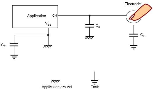

Capacitive sensing interfaces are more and more used in a wide range of applications. The interface is based on surface sensors that are made of small copper foils. The sensor acts as a capacitor that is alternatively charged and discharged. The capacitor value depends on the presence of the user finger as well as the sensor design. This application note introduces various sensor designs and recommendations to achieve optimum performances, keeping in mind that none of the sensor elements should interfere with each other.

Equivalent touch sensing capacitances
