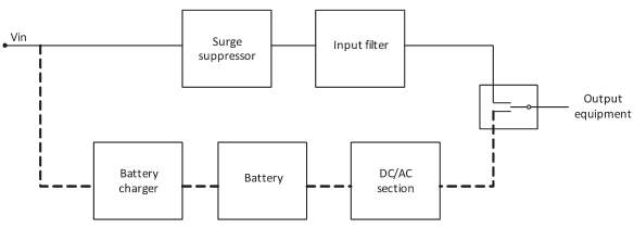

Uninterruptible power supplies (UPS) are widely used to avoid a sudden loss of data or information caused by a power supply disconnection (blackout). Power and voltage spikes, supply frequency changes, noise and radio frequency interference affect negatively the load. In figure, the basic schematic of a "standby UPS" is shown; it is the most common type of UPS present in the market. Surge suppressor and input filter protect the output equipment respectively from current spike and noise coming from input line. During an input supply failure, the transfer switch enables the battery-powered path.

Standby UPS schematic
