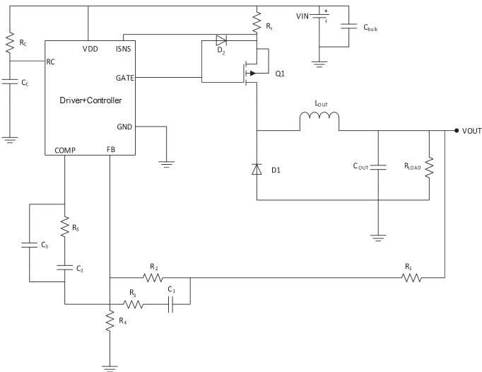

Non synchronous buck converter schematic
