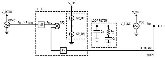

Figure shows the building blocks of a PLL system used for generating an LO signal. The PLL integrated circuit (IC) usually contains all clock dividers (R and N), phase/ frequency detector (PFD) and the charge pump, represented by the two current sources, ICP_UP and ICP_DN.
The VCO output is compared to the reference clock (the OCXO output here) after both signals are divided down in frequency by their respective integer dividers (N and R, respectively). The PFD block controls the charge pump to sink or source current pulses at the fPFD rate into the loop filter to adjust the voltage on the tuning port of the VCO (V_TUNE) until the outputs of the clock dividers are equal in frequency and are in phase. When these are equal, it is said that the PLL is locked. ...
