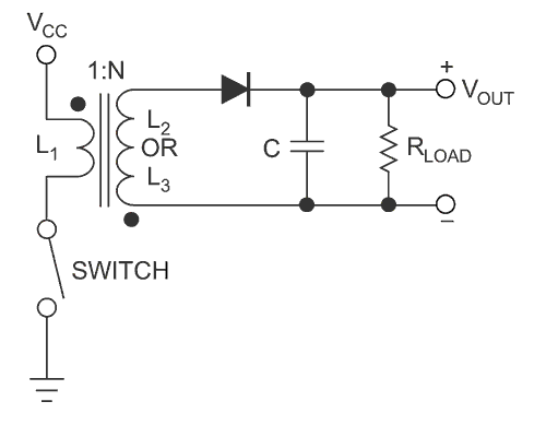

The operation is based on the flyback concept (Figure 1), where a small transformer is driven at 115 to 300 kHz generated by a pulse-width-modulated 555 astable circuit. The high frequency of operation allows the overall size of the circuit to be kept small while delivering relatively high power output with good regulation, and allows easier output filtering for low ripple.
In the actual circuit, you implement the switch using a MOSFET. In Figure 1, the diode is shown forward biased for positive VOUT. Reversing the diode direction and the polarity of one transformer winding gives a negative VOUT. The circuit operates in three distinct phases. In phase one, the switch is closed and energy is stored in a magnetic field due to current flowing in the transformer primary. The diode is reverse biased, and no current flows in the secondary.
Figure 1. This basic flyback converter pumps magnetically stored charge into filter capacitor C when the switch opens.
In phase two, the switch opens, the diode becomes forward biased, and the energy is transferred from the magnetic field into capacitor C. In phase three, with the energy dump completed, any residual charge stored on the switch drain-source capacitance is completely discharged. The cycle is then repeated.

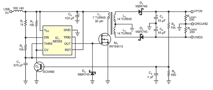

In the practical circuit of Figure 2, all of the elements of the basic flyback circuit of Figure 1 can be identified. However, there are a number of refinements that lead to better operation and stability. For example, two output diodes are configured so that dual-rail output is possible. Also, the positive rail feedback is sampled by the voltage divider comprising R4 and R5, with a level that is smoothed by capacitor C2. In normal 555 astable operation, the output waveform generation is possible since the timing capacitor (C1) charges from VCC through the sum of R1 and R2 and discharges through R2. With the resistor values used (that is, R2 >> R1), the duty cycle is close to 50%. The charging/discharging voltage levels are internally set to VCC/3 and 2VCC/3 (that is, 1.67 V and 3.33 V, respectively, if operated at 5 V). Without feedback, the values in Figure 2 give an open-loop output voltage of about 20 V.
 Derive an efficient dual-rail power supply from USB
Figure 2.  In this complete circuit, you can use many alternatives for M1, Q1, and the Schottky diodes.
The feedback operates as follows: The transistor, Q1, does not conduct until the voltage at its base (VBE) is around 0.55 V. This enables the output voltage to be calculated from
As the output voltage continues to increase under the action of flyback, Q1 is driven even harder, causing its collector voltage to fall. Since the collector is connected to the control input of the 555 timer that is nominally the upper limit above (2VCC/3), this causes the capacitor to charge and discharge at the same rate but through a narrower voltage range. This has the effect of reducing both the “on” and “off” times of the output pulses that drive the MOSFET switch. The net variation in both the frequency and the duty cycle (D) causes VOUT to fall and eventually lower the feedback voltage, with the effect of reducing the “on” time of Q1.
One aspect of the circuit that needs careful setting up is the flyback transformer. Several home-made transformers were tried and worked reasonably well. The solution settled on was to reuse the core of an RFI suppression inductor commonly found at the mains input end of switched-mode power supplies in television sets. The windings of the transformer primary are multi-filar to reduce their series resistance. For example, using four strands of 0.3-mm insulated copper wire closely wound seven turns gave an inductance of 30 μH for the primary with a measured series resistance of 0.03 Ω. A lower coil resistance reduces joule heating in the inductor as it is switched, leading to higher efficiency. A suitable commercially available ferrite core and bobbin set is available from RS-Electronics (RS stock number 647-9446, manufactured by Epcos).
A further refinement is the use of high-current, high-speed, and low-forward-voltage Schottky diodes for D1 and D2. An additional diode is used in reverse bias at the gate of the MOSFET to reduce RFI. Including a 100-mH choke on the 5 V USB line also reduces switching noises further.

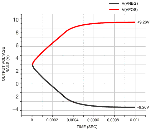

Figure 3.  At turn-on, the output stabilizes within 0.8 msec, with two loads of 200 Ω each.
For the purposes of our design, the USB port was modelled as a 5V source with a series resistance of 10 Ω for a worst-case current of 500 mA. A decoupling capacitor, C5, of 100 μF is used to prevent switching noises from being developed across the power rails. The measured output efficiency was around 72%, with a load of 50 Ω, with the output voltage dropping to ±7.6 V. The output has also been connected successfully to linear regulators such as the 78L05 for other voltages. A further design refinement is possible to make the output switchable under software control. We have not done it here, but some means of turning the 555 off or on using a separate active transistor would implement standby or active operation.

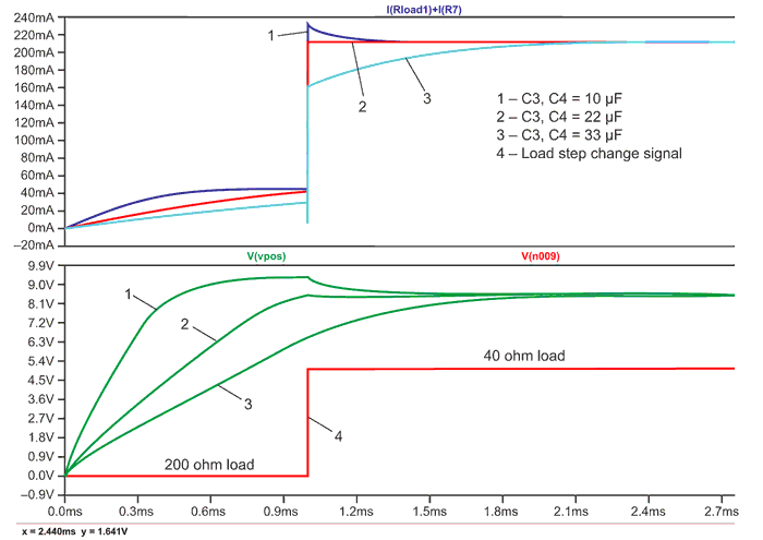

Figure 4.  The circuit respond to a step load change 10 msec after turn-on.
Figure 3 shows the turn-on transient response of the converter. Figure 4 shows that the circuit responds gracefully to a step load change 10 msec after turn-on.
