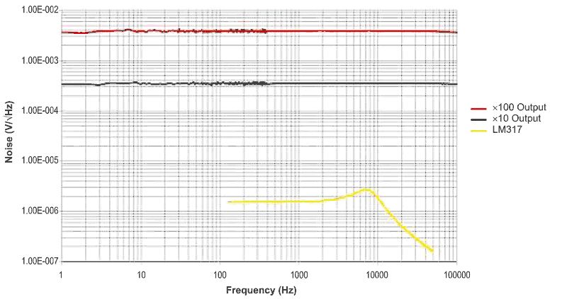

The intrinsic noise of the diode chosen when it is biased to 18 V through 1 MΩ is approximately 20 mV RMS. This was fortuitous scaling, as the P-P value is approximately five times this, or 100 mV P-P.

Figure 2 shows the resulting noise of the circuit, which is flat from 1 Hz to 100 kHz. The slight high frequency roll-off at 100 kHz in the x100 output is less than 0.5 dB and could be accounted for by adding some frequency dependent gain to U1B if desired, but for my purposes this was unneeded. For comparison, Figure 2 also shows the noise plot of an LM317 regulator operating with minimum capacitors, as this configuration is normally regarded as a “Very Noisy Regulator”, but it is nothing compared to a 12 V Zener diode and some gain.
Figure 2.  The power spectral density of the noise output is very flat from 1 Hz to 100 kHz. As a comparison, the noise of an LM317 regulator is also plotted, as this regulator is normally thought of as being very noisy.
