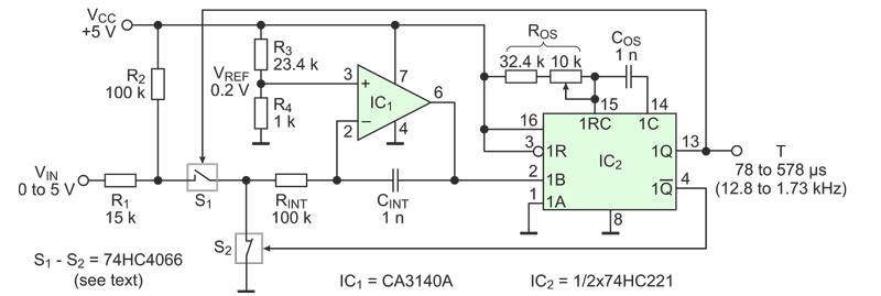

Figure 1 shows the circuit. It is a modified VFC (Ref 1), where the input voltage VIN and the reference voltage VREF swap their roles. The R1-R2 network shifts the input voltage so it is always more positive than the reference voltage and maintain proper operating conditions. The circuit uses all switches of the 74HC4066 part: two in parallel build S1 to reduce the effect of imperfect switch flatness on linearity, one switch goes for S2, and the last switch is part of the start-up circuit, paralleling CINT, and controlled by the logic during initialization, or as shown in Ref 1.

Figure 1.  The circuit uses a modified VFC architecture where the input voltage applies to the reference voltage terminal and vice versa.
When the circuit gets power, the start-up circuit shorts CINT for a while and the one-shot IC2 is reset by its internal circuitry. Switch S1 opens and S2 closes. The left side of RINT connects to the ground and the right side gets the potential of 0.2 V. After the start-up time is over, the switch in parallel to CINT opens and the capacitor start charging. The integrator makes a rising ramp. When the ramp reaches the ~2.5 V threshold, the one-shot triggers. Switch S1 closes and switch S2 opens. The right side of RINT gets a positive potential that depends on the input voltage, but is always greater than 0.2 V. The current through RINT reverses direction, and CINT starts discharging. When the one-shot interval is over, the cycle repeats.
As the input voltage changes from 0 to 5 V, the output period changes from 78 to 578 µs. Integration capacitor CINT and the threshold level of the one-shot’s Schmitt input do not participate in the period vs. voltage relation. Filling the period with 10 MHz clock pulses generates numbers from 780 to 5780 – one count per millivolt. Linearity is one count or ±0.02%, which is not a surprise when the maximum frequency is only 12.8 kHz. The maximum time of the A-to-D conversion is 578 µs. This is 8.65 times faster compared to the case of a 1 MHz VFC, where it would take 5,000 µs to count 5,000 pulses of 1 µs. The interface program is short and simple; very similar to what is presented in Ref 2.
Calibration involves some back and forth due to the shift of the input voltage: adjust sensitivity to 100 µs/V using the trim-pot of the one-shot. The nominal duration of the one-shot pulse is 26 µs. Cancel the 780 count offset in the controller.
