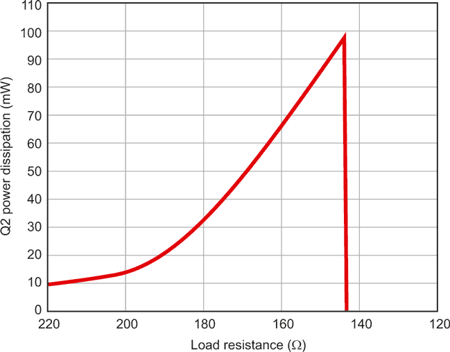

Using these values and a VS of 20 V, the power in Q2 increases linearly as the load resistance is reduced below 180 Ω since the circuit is in its current-limiting region (Fig. 2). When the load drops to about 144 Ω, Q2’s power reaches 494 mW. Reducing the load below 144 Ω causes Q2’s collector-emitter voltage to reach 5 V, at which point IC1 and Q3 turn fully on and cut off Q2. The dissipation immediately falls to 0, preventing damage to Q2.

Figure 2. Results from the example circuit show its very fast response, dropping Q2’s power dissipation to 0 if the load resistance drops
to a dangerous level.

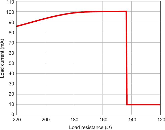

The load current changes correspondingly as the load resistance is reduced. Initially, the current ramps up linearly until it levels off at about 100 mA, the current-limiting region (Fig. 3). At the point where Q2 cuts off, the load current immediately falls to about 10 mA. The circuit is now latched in its “tripped” state, where the relatively low load current consists almost entirely of the current though IC1. The circuit remains in this off state until either the supply voltage is cycled off-on or until the load is disconnected.

Figure 3. The circuit’s load-current response to reducing the load resistance illustrates the current-limiting region from about 180 Ω to about
144 Ω, where the circuit trips, reducing current to 10 mA.
