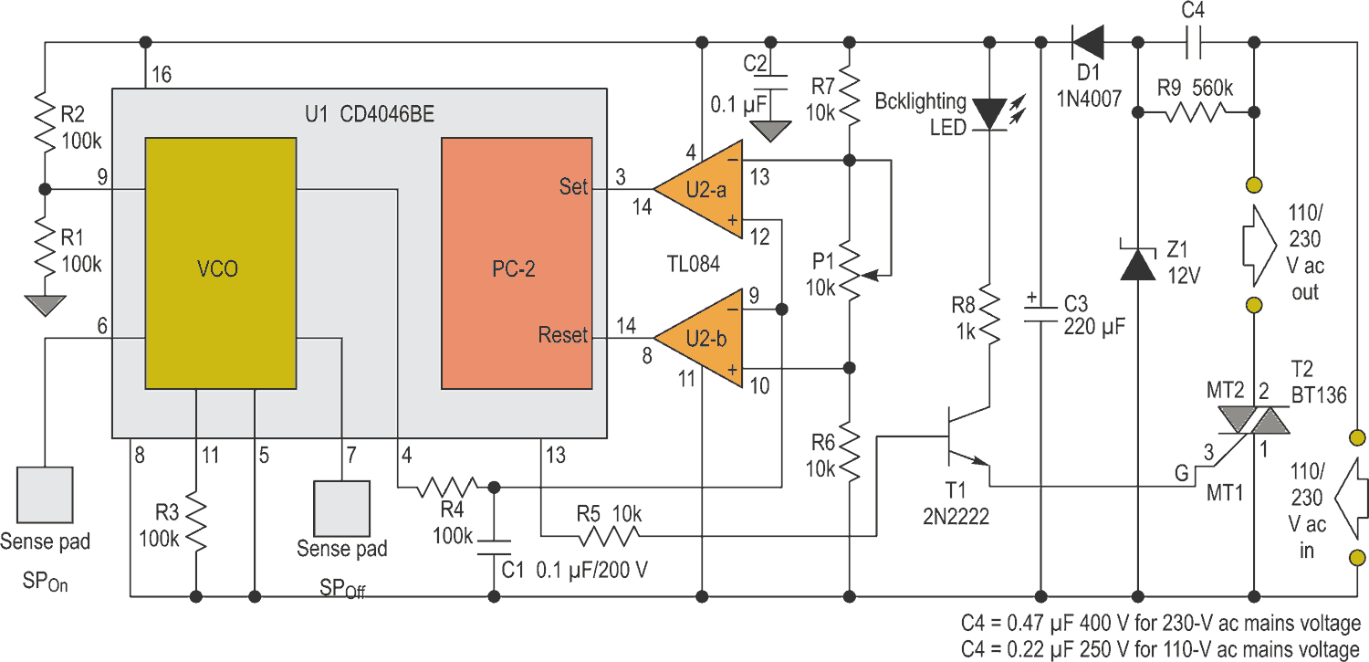

The circuit in the figure uses two identical metal plates or copper pads on one side of a double-sided PCB as the sensing pads (SPOn and SPOff). Sensing capacitors COn and COff are formed by placing these sensing pads behind a thin, decorative overlaying cover film or plate of the switch. The overlay isolates the user from the mains voltage. Components C4, R9, Z1, D1, and C3 form a compact and low-cost transformerless power supply.
Емкостной сенсорный выключатель для сетевых электроприборов
Figure 1. Based on a standard PLL IC, comparator, and triac, this circuit provides a low-cost capacitance touch switch for the ac line and is relatively insensitive to ambient temperature and dc-supply rail drift.
The capacitors act as the timing components of the voltage controlled oscillator (VCO) of a commonly used and inexpensive CMOS phase-locked loop (PLL) (CD4046). ON period TOn and OFF period TOff of the square wave at the output of the VCO are determined by the values of the sense capacitors COn and COff, respectively. Integrator R4C1 develops dc voltage Vdc proportional to the duty cycle (η) of the square-wave output:

Since the sensing pads are identical, the capacitors have equal values when the sensing pads are not touched. Hence, TOn = TOff, duty cycle = 0.5, and Vdc = 6 V. The voltage divider formed by R6, P1, and R7 provides reference voltages VRef-hi and VRef-lo to voltage comparators U2-a and U2-b.
When the sensing pad (SPOn) used for switching the appliance on is touched, the user’s finger capacitance will be added to the value of COn. This increases the values of TOn, the duty cycle, and the integrator output. Preset potentiometer P1 is adjusted so:
where Vdc and Vdc-on are the integrator outputs when SPOn is untouched and touched respectively.
Thus, when SPOn is touched, the integrator output exceeds VRef-hi, and the output of comparator U2-a goes high, setting the set-reset flip-flop, which is the phase comparator (PC-2) of the PLL IC.
Similarly, when sensing pad SPOff used for switching the appliance off is touched, the user’s finger capacitance will be added to the value of COff. This increases the value of TOff and decreases the values of duty cycle and the integrator output.
As R6 = R7, the reference voltage VRef-lo tracks VRef-hi such that:
(VRef-hi – Vdc) = (Vdc – VRef-lo)
Hence, when SPOff is touched, the integrator output falls below VRef-lo, and the output of comparator U2-b output goes high and resets the set-reset flip-flop of the PLL IC. A high level on the flip-flop output drives triac T2 to switch on the electrical appliance connected to it. A low level at the flip-flop output switches off the appliance.
The variation in the ambient temperature causes equal percentage variation in the values of COn and COff and hence in values of TOn and TOff. The values of duty cycle and Vdc are not affected, so the touch sensitivity is not altered. Also, as VRef-hi, VRef-lo, and Vdc are all ratiometric to the supply voltage Vdd, the touch switch action is immune to the supply-voltage variations.
