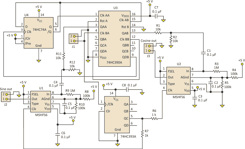

The example circuit uses an MSHFS6 5-V, low-power 12.5:1 switched-capacitor filter with selectable Butterworth, Bessel, or elliptic filters in the lowpass mode and full-, 1/3-, or 1/6-octave filters in the bandpass mode. Since the lowpass mode would cause a 3-dB loss of the signal output, the circuit uses the 1/6-octave bandpass filter, which is selected by tying pins 1 and 3 high on the MSHFS6 (Fig. 1).
Circuit Generates High-Frequency Sine/Cosine Waves From Square-Wave Input
Figure 1. Instead of a DDS IC, the sine/cosine generator uses simple CMOS logic and two switched-capacitor filters to provide a 1-MHz output at 3.0 V dc.
Two separate divider circuits are used. The 74HC393A divides the 50-MHz clock to 12.5 MHz. The 74HC390A is a dual divide-by-2 and divide-by-5 device. By combining the 74HC390 with the 74HC74A dual flip-flop, the 50-MHz clock can be divided to 500-kHz.

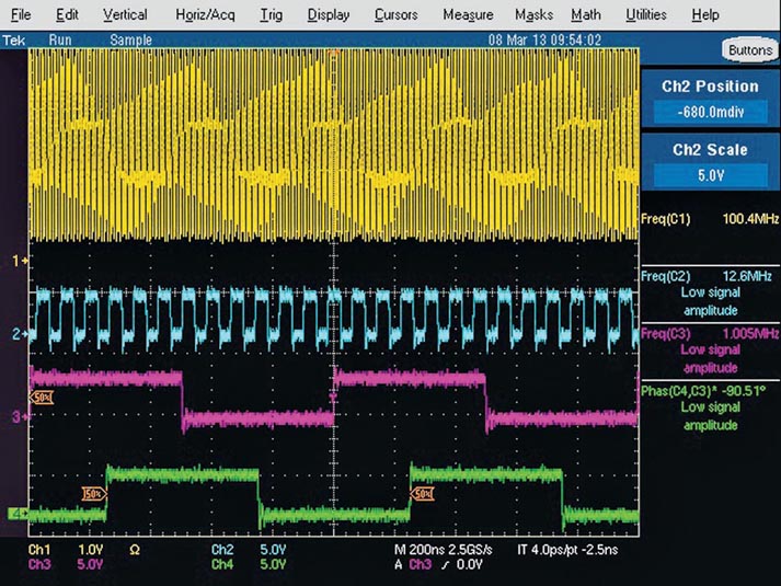

The 74HC74A provides a Q and /Q output at half the frequency of the divide-by-25 output of the 74HC390A. Dividing the 74HC74A output by 2 with the divide-by-2 blocks in the 74HC390A creates two square waves –90° apart. Figure 2 shows a 100-MHz square wave input, a 12.5-MHz output for the filter clock, and 1-MHz sine and –cosine square-wave output before the dividers.
Figure 2. The 1-MHz sine and –cosine outputs of the generator (channels 3 and 4) result from the 100-MHz square-wave input (channel 1).
Resistor-divider circuits reduce the amplitude from rail-to rail to prevent generation of distortion in the filters. The use of ac coupling at the MSHFS6 filter inputs ensures smoothed square waves centered around the filters’ analog ground.

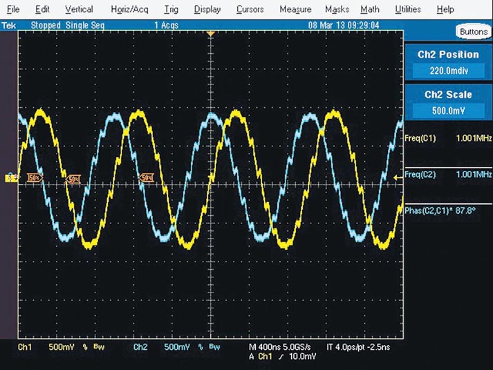

Figure 3 shows the output of the two filters with an input clock of nearly 50 MHz. If the inverted cosine is not acceptable, an op amp at the cosine filter output or the inverter at pin 13 of the 74HC390A can correct it.
Figure 3. Channels 1 and 2 show the outputs of the two switched-filter capacitors with an input clock of nearly 50 MHz.
The Lissajous curve for the two outputs (Fig. 4) indicates that the phase circle matches the 89.1° reading in Figure 3. Using a Krohn-Hite 6900B distortion analyzer and a 1-MHz Krohn Hite lowpass filter (to remove the clock), the circuit’s total harmonic distortion on the sine output was only 0.1%.
