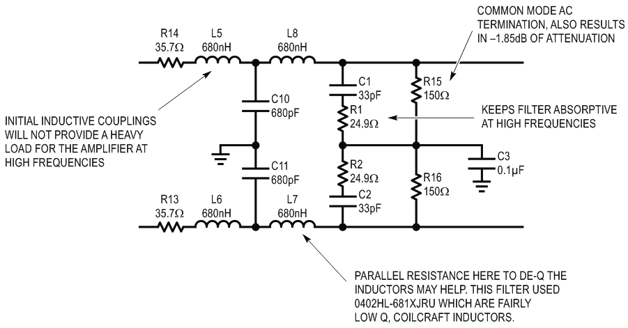

Figure 1. An Interface Filter of Approximately 10 MHz Used Between the LTC6409 and the LTC2270.
The interface filter limits the broadband noise from the driver, but without careful design, the filter can also deteriorate the SFDR. To obtain optimum SFDR specifications for the driver and the ADC, start with these broad guidelines:
  • Тhe ADC should see low impedance from its inputs. Since sampling is primarily a common mode effect, this termination should be common mode.
  • The driver should see relatively high impedance, especially when driving the ADC to full-scale.
  • Filters with absorptive (never open or short) characteristics behave better.
  • A common mode termination capacitor mitigates the effect of charge kickback on the driver and the ADC. A filter that contains common mode termination and properly settles charge kickback will optimize SFDR.

There are other interface filter design guidelines, especially concerning layout, but these considerations provide some basic direction. The filter in Figure 1 illustrates these specifications and performs well in lab. Figure 2 shows the full interface.

Here are a few practical rules to keep in mind for interface filter design:
  • Keep the filter symmetric in value and layout
  • Use only low distortion capacitors like COG/NPO, de-Q or use Low Q filter inductors
  • Provide common-mode roll-off
