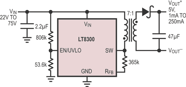

Figure 1. A Complete 5 V Flyback Converter for
a 22 V to 75 V Input.

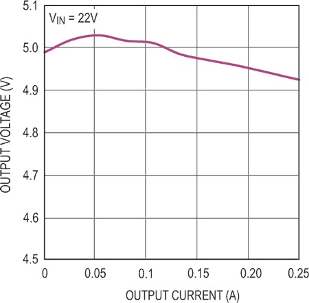

The LT8300 eliminates the need for an opto-coupler by sensing the output voltage on the primary side when the output diode current drops to zero during the primary switch-off period. This greatly improves the load regulation since the voltage drop is zero across the transformer secondary winding and any PCB traces. This allows an LT8300-based flyback converter to produce ±1% typical load regulation at room temperature. Figure 1 shows the schematic and Figure 2 the load regulation curves of a flyback converter with a 5 V output.
Micropower Isolated Flyback Converter with Input Voltage Range from 6 V to 100 V
Figure 2. Regulation of a 22 V to 75 V Input to 5 V Flyback Converter of Figure 1.

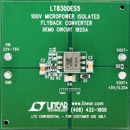

Figure 3 shows the standard demo circuit DC1825A for an isolated flyback using a small EP7 core transformer. The six key components are the input and output capacitors (C2, C3), output diode (D1), feedback resistor (R3), transformer (T1) and the LT8300. For the same application, a traditional flyback circuit would require, at minimum, eleven additional components, plus complicated start-up and bias power circuits in both the primary and secondary sides.

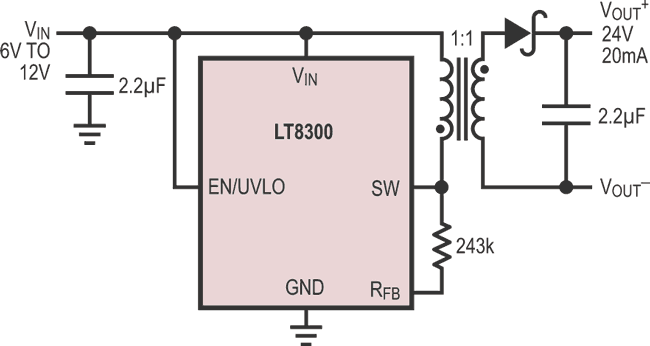

Figure 4. Flyback Converter Optimized for Low Standby Power (6 V–12 V to 24 V/20mA).

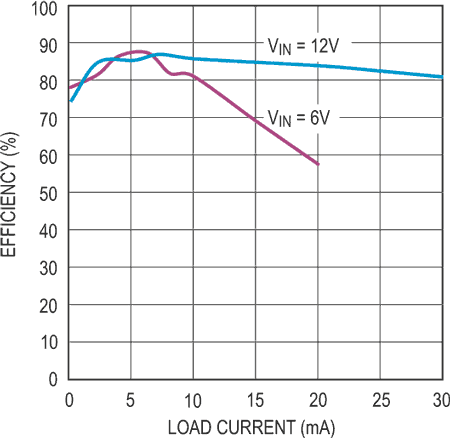

The typical minimum switching frequency is about 7.5 kHz, with the circuit requiring a very small preload (typical 0.5% of full load). Therefore, LT8300 power losses in standby mode are very low – important for applications requiring high efficiency in always-on applications. Figure 4 shows a solution that produces 20 mA at 24 V from a 12 V input. Efficiency peaks at 87%, and remains high at 84% with a 20 mA load, as shown in Figure 5.
Figure 5. Efficiency of the Converter in Figure 4.
