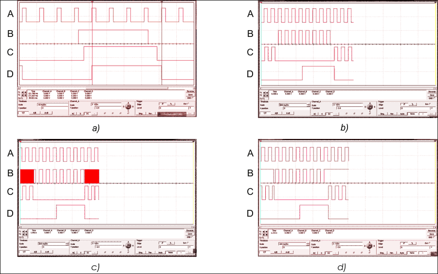

The signals on the Q1 and Q3 outputs have equal duration except when the sensor’s phototransistor detects IR rays reflected from an object. Figure 2a shows the process of this normalization. Exclusive-OR gate IC3B compares the Q1 and Q3 outputs from IC2. If they have the same logic level and duration, then IC3B’s Pin 6 is low, and IC3B generates pulse signals. If signals from outputs Q1 and Q3 on IC2 are unequal, you must reset counter IC5B’s reset signal, and its output 2Q2 at OUT2 is low. The Q2 outputs of counters IC5A, IC5B, and IC6A are low whenever the input signals of comparator circuits IC3A, IC3B, and IC3C are unequal. This situation occurs if Sensor 2 doesn’t detect an object or receive any external signals – for example, IR noise from fluorescent lamps or interfering ambient light, alternating light, or flashes.

Figure 2. Traces show the process of normalization (a) and three cases of using
the presented device (b, c, and d).
The outputs of IC3A, IC3B, and IC3C are equal only when all phototransistors detect a signal from their respective IR emitting diodes – that is, when a card is presented in front of Sensor 2 (Figure 2b). You must choose a clock frequency with regard to a delay time of the system. A leading edge triggers IC2, a 74HC175, and a falling edge triggers IC6B, a 74HC393. Because of the counters, this system automatically adjusts itself after any changes of frequency in its clock generator.
Thus, if counter IC5B does not have a reset signal during a period equal to four periods of a reference signal, its output (Pin 9) is high, and the counter latches through R8. The logic-high level appears on OUT2 until you remove the card. In this case, the detected inequality signal from the sensor with the reference signal and the counter, IC5B, causes a reset signal. Figures 2b, 2c, and 2d show three cases of using the presented device.
Figure 2b shows a case of normal operation. You can see the results of comparing a reference signal (Trace C) and a signal of IC1B’s output (Trace D). The signal of IC1B’s output (Trace B) is low when no card appears. When the card enters the zone of vision of a sensor (Trace B), it is a sequence of normalized pulses. The output of the device at Pin 9 of IC5B (Trace D) changes its level from low to high after four cycles of both signals, but it will immediately change to low if you remove the card.
Figure 2c shows operation of the device under strong IR noise. The signal of IC1B’s output (Trace B) contains some high-frequency signals if a card isn’t present and is a sequence of normalized pulses when a card is present. The output of the device at Pin 9 of IC5B (Trace D) indicates the presence of a card by changing its level from low to high after four cycles of these signals. It immediately changes to low if you remove the card from the zone.
Figure 2d shows operation of the device under ambient direct lighting. You can see the results of comparing signals. In this case, the signal at IC1B’s output (Trace B) is constant high when a card isn’t present. When the card enters a sensor’s zone of vision (Trace B), the signal is a sequence of normalized pulses. The output of the device at Pin 9 of IC5B (Trace D) indicates this condition by changing its level from low to high after four cycles of both signals. It immediately changes from high to low when you remove the card from the zone.
