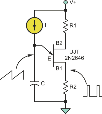

Unijunction transistors (UJTs) were common circuit elements several decades ago. A simple ramp generator could be built from a single UJT and a few other components (Fig. 1).
Ramp Generator Uses Microcontroller Emulation Of Unijunction Transistor
Figure 1. In a simple UJT-based ramp generator, the current source linearly charges the capacitor to create a voltage ramp. A synchronizing output pulse is also available.
The operating principle is simple. The base-emitter junction is initially in a high-impedance state, and the current source linearly charges the capacitor until a breakdown voltage is reached. At that point, the capacitor discharges through the UJT base until a lower threshold voltage is reached. Then, the base-emitter connection returns to a high-impedance state, and the capacitor can recharge.

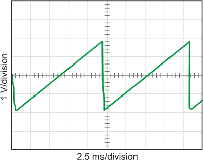

Figure 3. The ramp output repetition rate is about 85 Hz using the values shown. It can be changed via resistor R, which sets the charging current, and capacitor C.
When it reaches a threshold value, it switches the I/O pin from its high-impedance input state to an output state at ground potential. When the capacitor voltage goes below another threshold value, the I/O pin is switched back to a high-impedance state, and the cycle repeats (Fig. 3). The circuit also provides a pulse synchronized with the ramp cycles, which can be used for timing and triggering.
