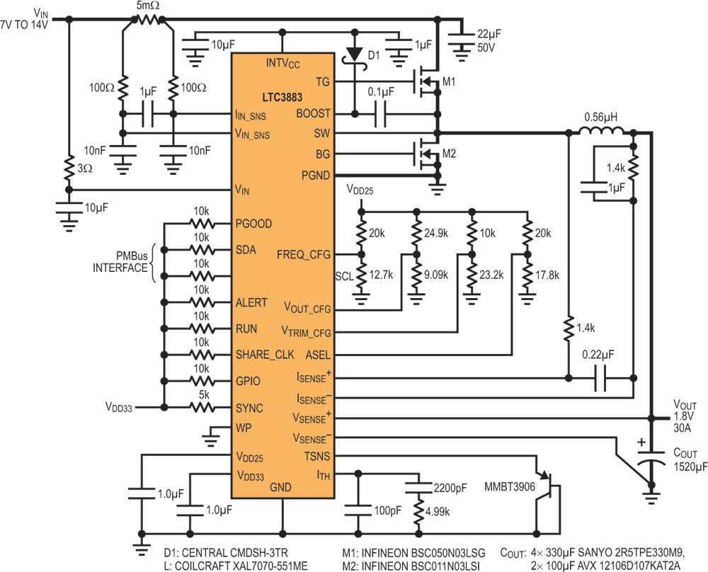

1.8 V/30 A Single Phase Digital Power Supply with IIN Sense
Figure 1 shows a 7 V to 14 V input, 1.8 V/30 A output application that features inductor DCR current sensing. To improve the accuracy of the DCR current sense, the LTC3883 senses inductor temperature and compensates for the temperature coefficient of the winding resistance. This method ensures the accuracy of the readback current and overcurrent limit.
High Performance Single Phase DC/DC Controller with Power System Management
Figure 1. 1.8 V/30 A Single Phase Digital Power Supply with IIN Sense.

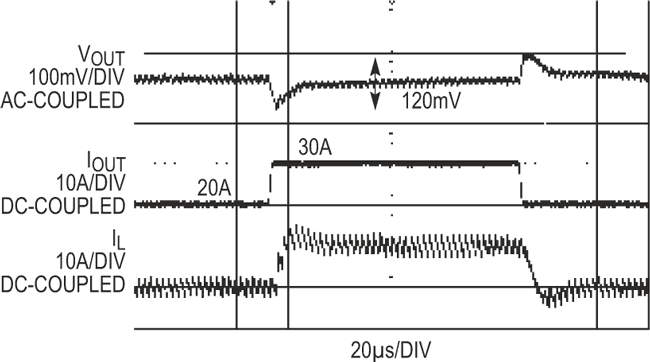

The LTC3883’s control loop uses peak current mode control to achieve fast transient response and cycle-by- cycle current limit. Figure 2 shows the typical waveforms for a 10 A load step transient, resulting in only a 60 mV maximum deviation from nominal.
Figure 2. Transient Performance for a 10 A Load Step.
Input Current Sensing
The LTC3883 features input current sensing via a resistor in series with the input side of the buck converter – a 5 mΩ sense resistor, as shown in Figure 1. The sense voltage is translated into a power stage input current by the LTC3883’s 16-bit internal ADC. In addition, an internal IC sense resistor senses the chip’s supply current at VIN, so it can provide both the chip and the power stage’s input current measurements.

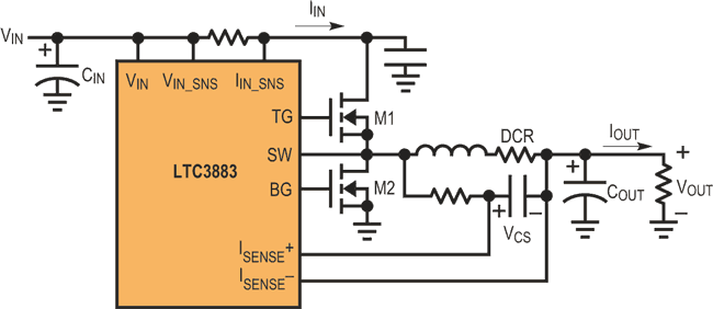

Inductor DCR Auto-Calibration
Figure 3. DCR Auto-Calibration.
The problem with conventional inductor DCR current sensing is that the tolerance of the DCR can be as large as ±10%, greatly limiting the current read back accuracy. To solve this problem, the LTC3883 uses a proprietary inductor DCR auto-calibration function. Figure 3 shows the simplified diagram of this circuit. The LTC3883 accurately measures the input current, IIN, the duty cycle (D) and the current sense voltage (VCS) and calibrates the real DCR value based on the relation:
With this auto-calibration method, the output current read back accuracy is within 3% regardless of inductor DCR tolerance.
