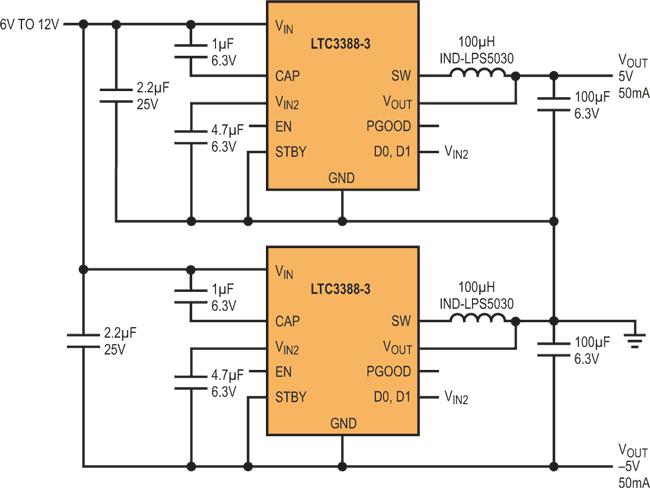

Analog circuits often need a split-voltage power supply to achieve a virtual ground at the output of an amplifier. These split-voltage power supplies are generally low power supplies supporting tens of milliamps of differential current loads. Figure 1 shows such a power supply using two LTC3388-3 20 V high efficiency step-down regulators powered from a 6 V–12 V power source.
The positive voltage rail is created by configuring one LTC3388-3 in its standard buck topology while the negative voltage rail is created with a second LTC3388-3 by grounding the VOUT connection and using the GND pin as the negative voltage rail. The negative voltage rail is connected to the exposed pad of this LTC3388-3 and must be isolated from the system ground plane and have sufficient surface area to provide adequate cooling of the LTC3388-3.

Figure 1. Easy split-voltage power supply.
A negative output voltage rail is created by grounding the VOUT node of the buck regulator. This sets the ground reference connection of the LTC3388 as a negative voltage rail. The voltage from the VIN pin to the negative voltage rail is the sum of the input voltage plus the magnitude of negative voltage rail. This limits the source voltage to 20 V (the LTC3388’s VIN(MAX)) minus the magnitude of the negative rail voltage.

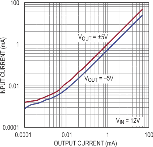

Figure 2. Input current versus output current for the split voltage power supply of Figure 1 (–5 V curve also applies to –5 V supply shown in Figure 3).

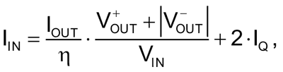

In a split voltage power supply application, the analog circuit is connected between the positive voltage rail and the negative voltage rail. This results in the load current of both regulators to be equal in magnitude. Figure 2 is a plot of the input current versus the output current for the circuit in Figure 1. At very low load currents, <10 μA, the effect of the input quiescent current can be seen as a positive offset in the input current. For higher load currents, >100 μA, this effect is minimal and the input current is approximately equal to the output current. The expression for the input current may be approximated as:
η = EFFICIENCY

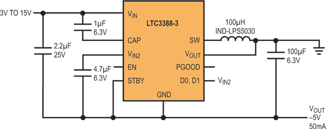

Negative Voltage Supply
Figure 3 shows the buck-boost configuration creating a negative output voltage rail. In this configuration the input voltage needs only be above the UVLO voltage of 2.5 V (typ) to start the regulator. The –5 V curve in Figure 2 applies here with a 12 V input, as in the previous circuit.
Easy, ±5 V Split-Voltage Power Supply for Analog Circuits Draws Only 720 nA at No Load
Figure 3. Negative voltage power supply.
