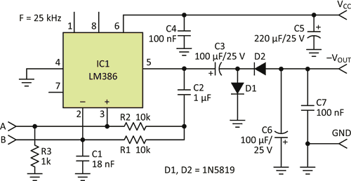

Inverting the positive power supply
a) Comparing the NE555 Timer and LM386 Amplifier as Inductorless DC-DC Converters
b) Comparing the NE555 Timer and LM386 Amplifier as Inductorless DC-DC Converters
Figure 2. With a modest reconfiguration, the NE555 (a) and LM386 (b)
can be used to invert a positive supply rail.
Table 2 compares the output voltages at several load resistances for inverting a positive power supply with the NE555 (Fig. 2a) and LM386 (Fig. 2b). Again, the converter with the LM386 audio amplifier can provide more power to the load, which is a result of its higher output-current rating.

*The NE555 timer begins to overheat and temperature is not
measured, while the LM386 does not overheat.

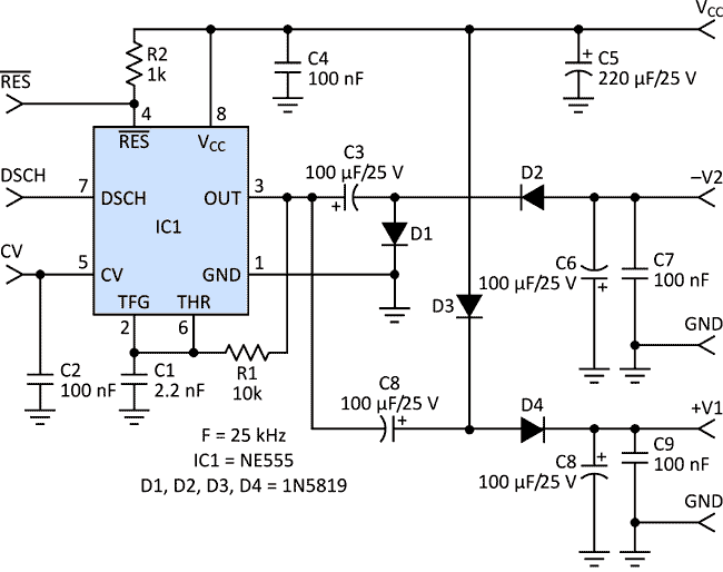

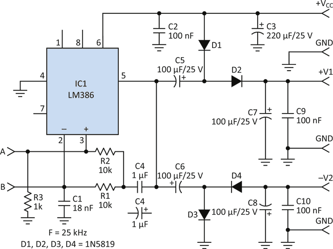

 Doubling and inverting the positive power supply
We can combine the previous converter circuits and develop converter designs that produce two output voltages, with one as a positive rail higher than the power-supply VCC and the other a negative output voltage. Figure 3a shows a NE555-based dc-dc converter, while Figure 3b uses the LM386. The circuit with the NE555 provides less total output current and power compared to the circuit using the LM386.
Figure 3. The doubling and inverting circuits can be merged to produce circuits
that do both, while using only a single NE555 (a) or LM386 (b).
In conclusion, the popular 8-pin, bipolar NE555 timer and the low-power LM386 audio amplifier can both be used as the core of inductorless dc-dc converters. The LM386 has some advantages compared to NE555, but the final choice may also depend on factors beyond those examined here.
