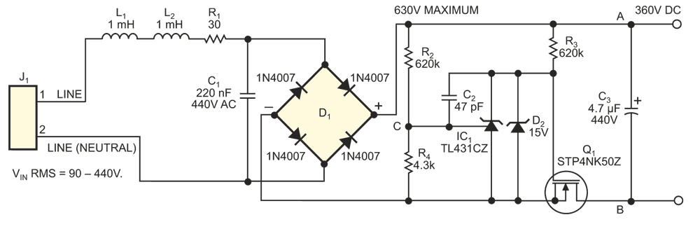

The circuit in Figure 1 limits, or clamps, input-ac voltages higher than 260 V rms to levels safe for the operation of the power MOSFET in an SMPS. The circuit employs MOSFET Q1 working as a 100-Hz switch and shunt-regulator IC1, a TL431CZ, setting the clamped high-voltage level by divider R2 and R4. The circuit uses the component values shown. The clamped output voltage is 360 V dc, the input voltage is 260 V rms, and the maximum input voltage is 440 V rms. The circuit was tested at power levels of 5 to 10 W.
Use a TL431 shunt regulator to limit high ac input voltage
Figure 1. This simple circuit clamps input-ac voltages higher than 260 V rms to levels safe
for the operation of the power MOSFET in a switched-mode power supply.
At an input voltage of less than 260 V rms, Point C is less than 2.5 V, and IC1 is off, sinking the minimum off-state cathode current. Zener diode D2 breaks down to 15 V, ensuring a stable on-state for Q1. This operation is the normal condition of Q1 at input voltages lower than 260 V rms. Accordingly, at these voltage levels, the circuit works as a standard full-bridge rectifier under capacitive load C3.
At an input voltage of 260 V rms or greater, Point C becomes higher than 2.5 V, and IC1 turns on, diverting and sinking the current from D2. The gate-to-source voltage of Q1 drops to approximately 2 V, and Q1 switches off. Now, no current flows to charge bulk capacitor C3 even if the D1 bridge-rectifier diodes are forward-biased. The rectified input-ac voltage is higher than the voltage across C3, but Q1 is off, the loop is interrupted, and no current flows. Accordingly, the output-dc voltage across C3 gets limited because no charging current is available.
When the rectified ac-input voltage starts decreasing, it eventually hits the 2.5 V threshold level of Point C, and Q1 again switches on. But current does not flow because the rectifier bridge’s diodes are now reverse-biased; the rectified input-ac voltage is less than the voltage across C3. The voltage across C3 decreases at a rate that the output-power level determines. Eventually, the voltage across C3 and the rectified input-ac voltage intersect at a level when the rectifier bridge’s diodes get forward-biased. Q1 is still on; therefore, charging current starts flowing. A short interval follows, during which both Q1 and D1 conduct. The short charging pulses replenish the energy loss, increasing the voltage to the limited level. When the input voltage gets higher than 260 V rms, Q1 again switches off, and the whole process repeats.
Q1 has small power dissipation. During every switching period, the MOSFET is on for only 450 µsec, resulting in high efficiency for this high-voltage-limiting circuit. You can use it as a MOSFET switch with the STMicroelectronics SuperMesh MOSFET STP4NK50Z, which comes in a TO-220 package, but you can also use a Dpak to save space because the MOSFET is not a dissipative-voltage limiter. The current through Q1 gets interrupted when the 50/60-Hz rectifying diodes are forward-biased. This current interruption causes ringing on the drain-to-source voltage. The clamping circuit passed the conducted EMI (electromagnetic-interference) tests, according to EN 55022 Class B, using peak and average detection. The 1-mH, 0.2 A chokes, L1 and L2, suppress EMI. The 220-nF, 440 V-ac capacitor, C1, is a simple snubber element across the rectifying diodes of the D1 bridge.
