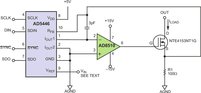

The input stage of the circuit, shown in Figure 1, is composed of a current output DAC (AD5446) and its op amp (AD8510). It provides the conversion of the command word and drives the transistor. It also modulates the voltage applied to the single resistor. The command word is sent via an SPI interface.
Versatile High Precision Programmable Current Sources Using DACs, Op Amps, and MOSFET Transistors
Figure 1. Current Source Using a Current Output DAC (All Connections and Decoupling Not Shown).
The output stage is composed of an N-channel MOSFET transistor (NTE4153N), which can provide more current than the output of the op amp and a single resistor. The single resistor, R1, produces the current with the voltage applied to its pins. The transistor regulates this current.
The load current is
where D is the fractional representation of the digital word loaded into the DAC. However, RDAC >> R1, (RDAC is nominally 9 kΩ); therefore, the load current can be approximated as
With R1 = 100 Ω and VIN = −5 V, ILOAD is programmable from 0 mA to 50 mA with a resolution of 3 μA (1 LSB at 14 bits). The output compliance voltage is approximately 20 V and is limited by the breakdown voltage of the MOSFET transistor. The ADR425 is an ideal 5 V low power precision reference for this circuit, but its output must be inverted with an additional op amp to generate the −5 V reference.

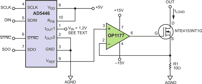

The circuit shown in Figure 2 also uses the AD5446 DAC. However, in this case the DAC is used in the reverse or voltage mode, which provides a voltage output by using a 1.2 V voltage reference such as the ADR512.
Figure 2. Current Source Using a Current Output DAC Connected in the Reverse Voltage Mode
The DAC output voltage range on Pin 9 varies from 0 V to 1.2 V. See the AD5446 data sheet for more details on the reverse voltage mode of operation.
The op amp used in this case is the OP1177. It is a high precision and very low offset device (60 μV maximum). Low offset voltage is essential when the DAC is used in voltage output mode because of the reduced signal swing.
The N-channel MOSFET transistor in conjunction with the op amp makes a high current output follower circuit.
The negative feedback from the source pin of the transistor to the op amp input regulates the value of the current through the R1 resistor.
The load current is
With R1 = 10 Ω and VIN = 1.2 V, ILOAD can be programmed from 0 mA to 120 mA with a resolution of 7 μA (1 LSB at 14 bits).

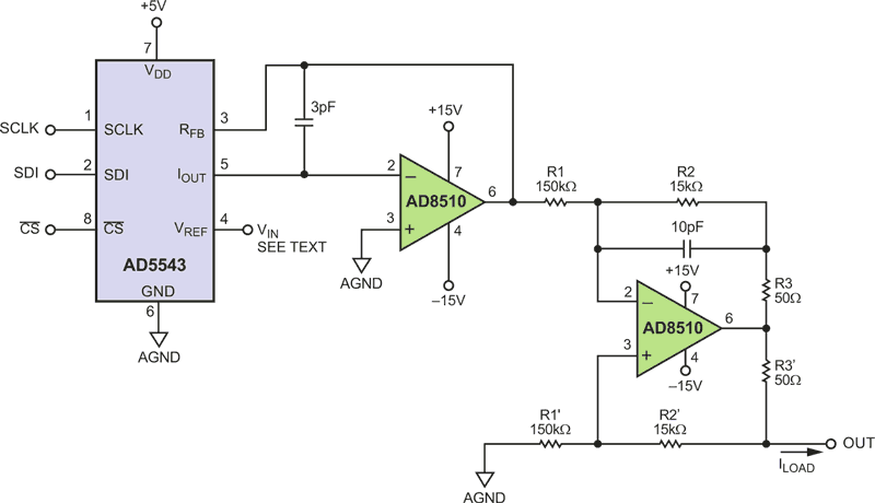

The third circuit, shown in Figure 3, uses an AD5543 16-bit DAC as the input and a Howland current pump circuit as the output stage. Howland current pumps have two advantages over MOSFET outputs: high output impedance and the ability to provide bipolar output currents. Usually, to improve stability, the circuit is symmetrical. Therefore R1 = R1', R2 = R2', and R3 = R3'.
Figure 3. Bipolar Current Source Based on the Howland Current Source (All Connections and Decoupling
Not Shown).
The load current is (see the AN-843 Application Note for derivation)
Output impedance is
With R1 = 150 kΩ, R2 = 15 kΩ, R3 = 50 Ω, and VIN = 10 V, ILOAD is programmable from 0 mA to 20 mA with a resolution of 300 nA (1 LSB at 16 bits), and the circuit has a very high output impedance.
Excellent layout and grounding and decoupling techniques must be used in all three circuits to separate correctly DACs and op amps and to achieve the desired performances (see the MT-031 and MT-101 tutorials).
