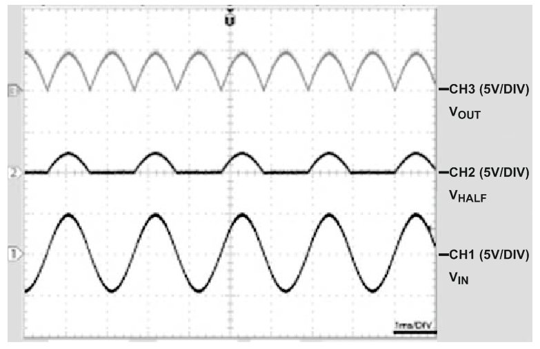

The circuit operates as follows: If VIN > 0 V, then IC1A's output, VHALF, equals VIN/2, and IC1B operates as a subtracter, delivering an output voltage, VOUT, equals VIN. In effect, the circuit operates as a unity-gain follower. If VIN, 0 V, then VHALF = 0 V, and the circuit behaves as a unity-gain inverter and delivers an output of VOUT = –VIN. Figure 2 shows the circuit's input signal at VIN; its intermediate voltage, VHALF; and its output voltage, VOUT.

Figure 2. From bottom to top, the waveforms show
VIN (CH1), VHALF (CH2), and VOUT (CH3).
