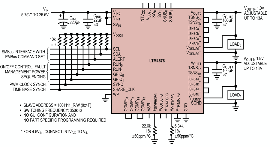

Dual μModule Regulator with Precision READ/WRITE of Power Parameters
The LTM4676 is a dual 13 A output constant frequency switching mode DC/DC μModule (micromodule) regulator (Figure 1). In addition to delivering power at a point-of-load, the LTM4676 features configurability and telemetry-monitoring of power and power management parameters over PMBus – an open standard I2C-based digital serial interface protocol. The LTM4676 combines best-in-class analog switching regulator performance with precision mixed signal data acquisition. It features ±1% maximum DC output voltage error and ±2.5% current read back accuracy over temperature (TJ = –40 °C to 125 °C), and integrated 16-bit delta-sigma ADC and EEPROM.
Dual 13A μModule regulator with digital interface for remote monitoring & control of power
Figure 1. LTM4676: Dual 13 A Output μModule Regulator with PMBus Interface.
The LTM4676’s 2-wire serial interface allows outputs to be margined, tuned and ramped up and down at programmable slew rates with sequencing delay times. Input and output currents and voltages, output power, temperature, uptime and peak values are readable. The device is comprised of fast, dual analog control loops, precision mixed signal circuitry, EEPROM, power MOSFETs, inductors and supporting components housed in a 16 mm × 16 mm × 5.01 mm BGA (ball grid array) package.
The LTM4676 operates from a 4.5 V to 26.5 V input supply and steps down VIN to two outputs ranging from 0.5 V to 5.4 V. Two outputs can current share to provide up to 26 A (i.e., 13 A + 13 A as one output).

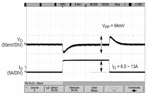

Internal or External Compensation
The LTM4676 offers both internal or external compensation, which can optimize the transient response over a wide operating range. Figure 2 shows that the peak-to-peak output voltage is only 94 mV with a 50% load step.
Figure 2. Transient Response of the LTM4676 in Figure 1 at VIN = 12V,
VOUT1 = 1.8 V, IO = 6.5 A ~ 13 A
