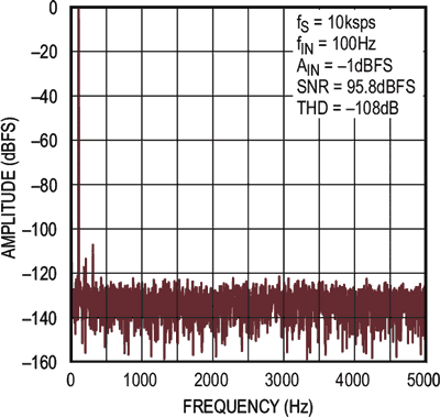

Figure 2. 8192-Point FFT for the Circuit of Figure 1.

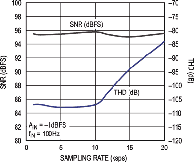

Figure 3. SNR and THD vs Sampling Rate for the Circuit of Figure 1.

Figure 2 shows an 8192-point FFT of the LTC2348-18 driven pseudo-differentially by the buffer of Figure 1. THD is –108 dB and SNR is 95.8 dBFS at 10 ksps, which compares well with the typical specs of the LTC2348-18. Figure 3 shows SNR and THD vs sampling rate. SNR stays fairly flat near 96 dBFS up to 10 ksps. THD starts to rise above –108 dB at 10 ksps.

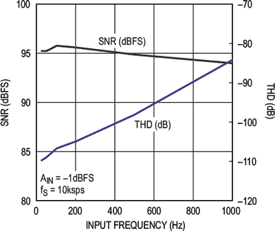

Figure 4. SNR and THD vs Input Frequency for the Circuit of Figure 1.

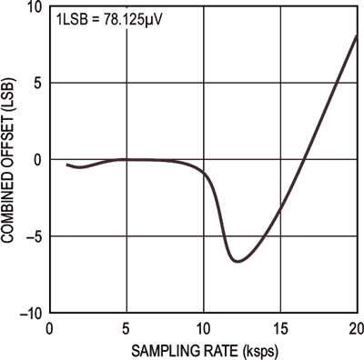

Figure 4 shows SNR and THD vs input frequency. Both SNR and THD slowly degrade from the typical specs of the LTC2348-18 above 100 Hz until at 1 kHz SNR is 94 dBFS and THD is –85 dB. Figure 5 shows the combined offset error of the LT6020 driver and ADC vs sampling rate. Offset is initially less than 1 LSB and starts to degrade as the sampling rate exceeds 10 ksps.

Figure 5. Combined ADC and Driver Offset vs
