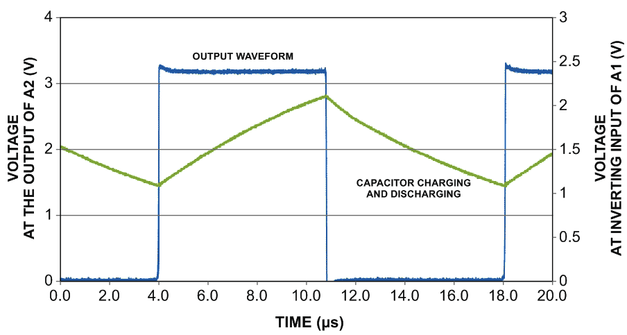

Low-Power, Battery Powered Square Wave Oscillator with Hibernation Mode
Figure 2. The output waveform of the low cost square wave oscillator.
