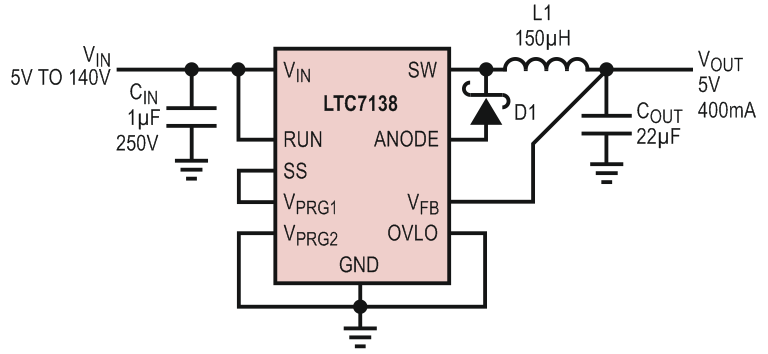

Simple 5 V/400 mA Buck with Wide VIN Range
Figure 1 shows a 5 V buck converter with a maximum input voltage of 140 V using only four external components. Its output is set to 5 V by tying the VPRG1 pin to the SS pin and the VPRG2 pin to ground. It does not require any external compensation.

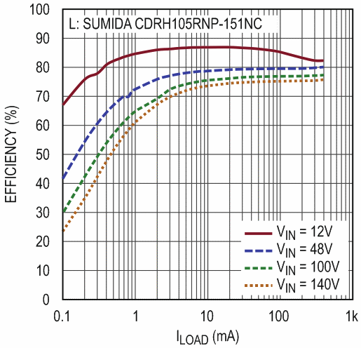

Efficiency remains high over a broad range of loads due in part to the LTC7138’s Burst Mode® operation and 12 μA no load IQ current (Figure 2). For a 12 V input, efficiency peaks at 87% for a load of 10 mA and stays above 80% for loads down to 0.4 mA. This level of energy conservation makes it ideal for always-on battery operated systems.

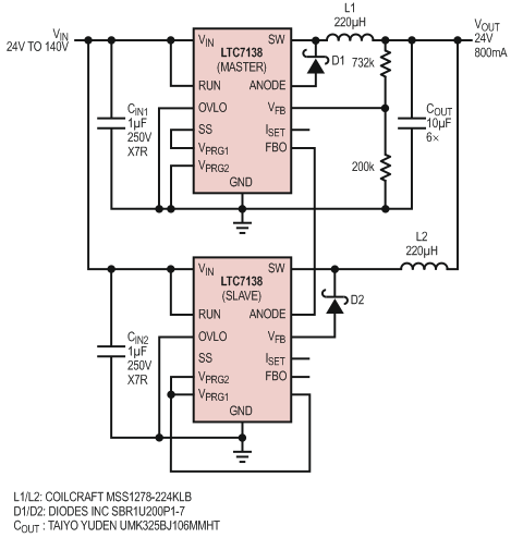

24 V/800 mA Buck Using Two LTC7138s in Parallel
Robust 140 V VIN, 400 mA Step-Down Regulator for Industrial, Telecom and Automotive Environments
Figure 3. High Efficiency 24 V, 800 mA Buck Using Two LTC7138s in Parallel.

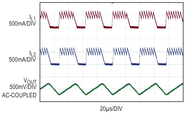

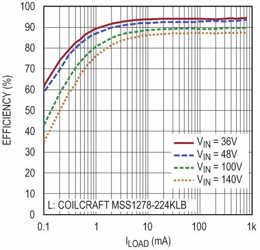

Figure 3 shows two LTC7138s paralleled to provide an output of 24 V at 800 mA. Parallel operation is implemented by tying the feedback comparator output pin (FBO) of the master to the VFB pin of the slave. In this setup, the slave follows the master as it enters and exits the burst cycles (see Figure 4). The output of the 24 V buck is set with an external feedback divider. The full load efficiency for this regulator is 93.6% for a 48 V input (Figure 5).

Figure 4. Parallel Operation of the 24 V, 800 mA Buck
at VIN = 140 V, IOUT = 600 mA.

Figure 5. Efficiency of the Regulator in Figure 3.

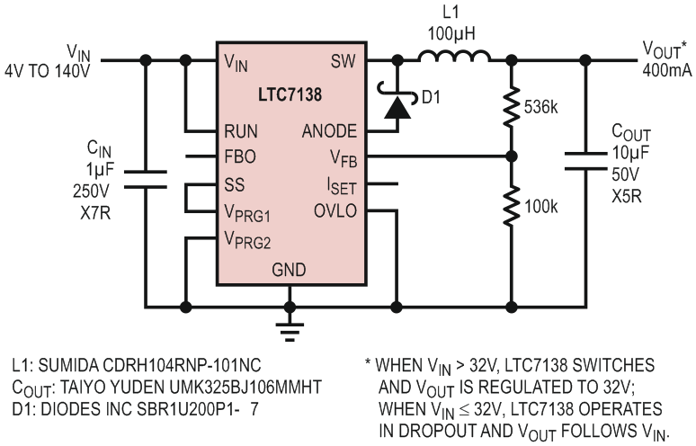

32 V/400 mA Surge Stopper
Figure 6. 32 V, 400 mA Surge Stopper.
Figure 6 shows another use for the LTC7138. For inputs of 32 V or below, this regulator operates in dropout, where the internal power FET is on continuously. When the input exceeds 32 V, the LTC7138 switches to keep the output voltage in regulation, as shown in Figure 7. For further protection, an overvoltage lockout can be implemented by tying the OVLO pin to a divider across the input supply. This circuit is suitable for protecting downstream converters or loads in industrial, automotive or avionics systems.
Figure 7. Output of the Surge Stopper (Figure 6) Is Clamped to 32 V
During 127 V Input Transient.
