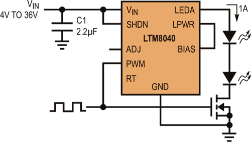

The high level of integration in the LTM8040 minimizes external components and simplifies board layout. As shown in Figure 1, all that is necessary to drive an LED string up to 1 A is the LTM8040 and an input decoupling capacitor. Even with all this built-in functionality, the LTM8040 itself is small, measuring only 15 mm × 9 mm × 4.32 mm.
μModule LED Driver Integrates All Circuitry, Including the Inductor, in a Surface Mount Package
Figure 1. Driving an LED String with the LTM8040 Is Simple –
Just Add the Input Capacitor and Connect the LED String.

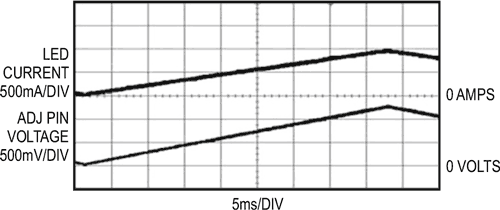

Figure 2. Drive a 0 V to 1.25 V Voltage into the ADJ Pin to
Control the LED Current Amplitude.

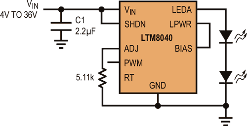

The LTM8040 features an ADJ pin for precise LED current amplitude control. The ADJ pin accepts a full-scale input voltage range of 0 V to 1.25 V, linearly adjusting the output LED current from 0 A to 1 A. Figure 2 shows the ratiometric response of the output LED current versus the ADJ voltage. The ADJ pin is internally pulled up through a 5.11 k precision resistor to an internal 1.25 V reference, so the output LED current can also be adjusted by applying a single resistor from ADJ to ground, as shown in Figure 3.
Figure 3. Control the LED Current with a Single Resistor
from ADJ to Ground.

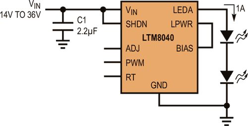

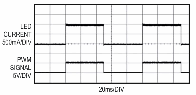

The PWM control pin allows high dimming ratios. With an external MOSFET in series with the LED string as shown in Figure 4, the LTM8040 can achieve dimming ratios in excess of 250:1. As seen in Figure 5, there is little distortion of the PWM LED current, even at frequencies as low as 10 Hz. The 10 Hz performance is shown to illustrate the capabilities of the LTM8040 – this frequency is too low for practical pulse width modulation, being well within the discrimination range of the human eye.
Figure 5. The LTM8040 Can PWM LED Current with Minimal Distortion,
Even at Frequencies as Low as 10 Hz.

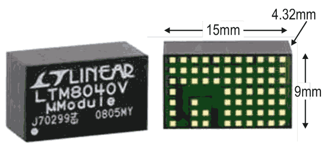

Figure 6. Only 9 mm × 15 mm × 4.32 mm, the LTM8040 LED Driver
is a Complete System in an LGA Package.
