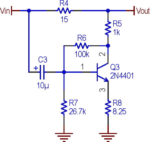

Figure 3 shows the less well known "Active Regulator" [1]. There have also been a number of other active regulators proposed over the years, but most of them have been focused on ripple reduction, not noise floor reduction [2].
Simple circuits reduce regulator noise floor
Figure 3. The Active Regulator, while not as popular as the Capacitance Multiplier, it does show
up from time to time in published circuits. I first saw this circuit on Charles Wenzel's
Website [1]. Typically R4, R5 and or R8 need to be adjustedto get the noise reduction
gain optimized for each circuit where this circuit is applied.

The active regulator of Figure 3 works by sensing any noise at the input; transistor Q3 then amplifies and inverts the noise and subtracts it by adding an equal and opposite current across resistor R4. Thus in theory the noise reduction is perfect, but in practice greater than 40 dB noise reduction can be achieved.
The Active Regulator also has a high-frequency limitation because the transistor is working as an amplifier – it will have a gain-bandwidth limitation as well, which limits the circuit's effectiveness at higher frequencies. In practice I find that bandwidths of 1 MHz are not difficult to achieve and at that point the standard capacitor bypassing is very effective at keeping the noise floor low.
Note that while the Capacitance Multiplier usually works without any modification, the Active Regulator of Figure 3 must usually be optimized for every application.
To get optimum noise reduction, the gain of the transistor stage must usually be adjusted and the easiest way to do that is to temporarily replace R8 with a 10- or 20-Ohm potentiometer. The potentiometer is then adjusted for optimum in-circuit gain that results in minimum output noise; the potentiometer can then be replaced with a fixed resistor.

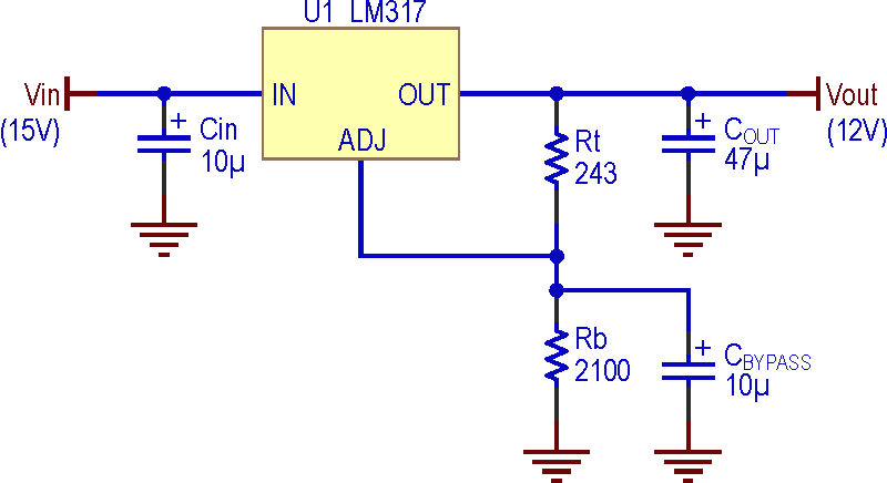

To test the noise reduction capability of the circuits I used an LM317 because this is typical of what might be used in a system. The LM317 has a bad reputation as being a particularly noisy regulator. However, this reputation is not totally deserved as we will see later.
Figure 4. A LM317 regulator biased up for 12 Volt operation was used as the noise
source for testing the noise reduction regulators.
The LM317 is an excellent noise source for testing the regulator circuits as the noise was fairly flat over the 120 to 50,000-Hz test frequency range. It drives the test circuits well and the noise is constant enough with load to make the testing valid. Figure 4 shows the test circuit and its components.

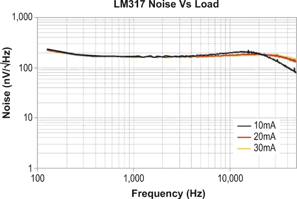

Figure 6. The noise of the LM317 was tested versus various load values to
make sure that the noise was consistent and stable with load current.
For my noise testing purposes, I made Cbypass equal to zero to maximize the noise input to the test circuits to maximize the measurement dynamic range.

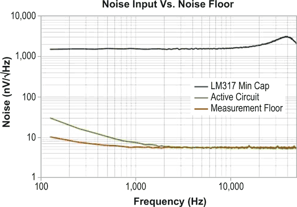

Figure 8 is a similar test using the Active regulator of Figure 3.
Figure 8. Testing the optimized active regulator of Figure 3 (Green Trace) also shows a dramatic
reduction of the LM317 input noise (Blue Trace). The measurement system noise
floor is shown in the Orange Trace.

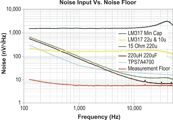

Figure 9 is a comparison of many different regulators and possible discrete filter circuits.
Figure 9. Grab Bag Comparison plot of the LM317, a TI TPS7A4700 ultra low noise regulator
and a few passive filters made from a 220-µH / 220-µF LC combination
and a 15-Ohm / 220-µF RC combination.
The LM317 with minimum bypassing is shown along with the LM317 with recommended bypassing. The addition of one small 10-µF tantalum capacitor from the adjust pin to ground reduces the LM317 noise by nearly 10 times!
For comparison the ultra-low-noise Texas Instruments TPS7A4700 regulator is also plotted (from data sheet values, not measured). As can be seen this state-of-the-art low-noise regulator is nearly 10 times lower noise at 10 kHz than the LM317 with the recommended bypassing and nearly 100 times lower noise than the hastily applied LM317 without the bypass capacitor.
A few small passive circuits were also built and tested for comparison. The 220-µF capacitor was chosen to be about the same physical size as the active regulator circuit of Figure 3, with a very small 220-µH inductor that was chosen to have a series resistance of around 15 ohms. Then a 15-Ohm, 220-µF capacitor combination was also tested.
These passive circuits do indeed reduce the higher-frequency noise, but the corner frequency is quite a bit higher than any of the transistorized circuits. As can be seen, the combination of these circuits with an LM317 does start to approach the performance of the TI TPS7A4700 by itself, which is pretty good for such an old part as the LM317 (developed around 1970 [5]).
While newer ultra-low-noise regulators may be 10 to 100 times lower noise than the generations-old regulators commonly in use, these transistorized noise filtering circuits can still improve the noise performance of even the lowest of the low-noise regulators available today.
