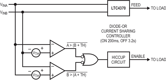

The solution described here senses input voltage differences and disables the downstream load when a defined voltage difference between the supplies is detected. This voltage difference is programmed to be below the maximum voltage threshold of the LTC4370. If an out of balance condition is detected, the downstream power supply is disabled. To prevent an oscillatory condition, the circuit enters hiccup mode, where the supply is cycled on for 200 ms every 3.2 seconds. The block diagram is shown in Figure 1.
Using a Current Sharing Controller with Non-Redundant Supplies
Figure 1. Block Diagram of Current Summing Circuitry.
As shown in the block diagram, two comparators are used to sense when the absolute value of the difference between power supply inputs VINA and VINB is beyond that allowed for proper current sharing. When this happens, the output of the negative true OR gate is a logic high, enabling the hiccup circuit. Normally, the output of the hiccup circuit is a logic high, enabling the downstream load. When the out of range fault condition is detected, the hiccup circuit is activated, causing a logic low to disable the downstream load. The hiccup circuit monitors the voltage differential during the 200 ms on period and is disabled when the fault condition is cleared.

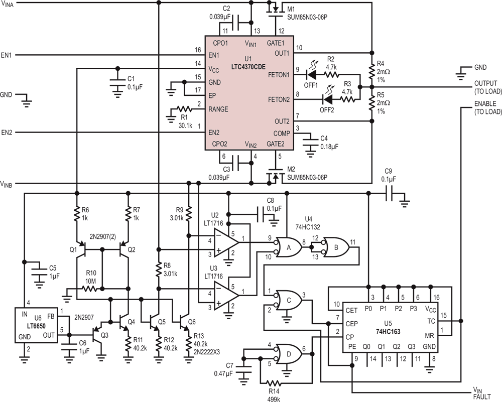

Figure 2 shows the complete solution. In Figure 2, U2 and U3 are LT1716 Over-The-Top® voltage comparators used to detect voltage differences between VINA and VINB.
Figure 2.
Threshold offset voltage to the comparators is provided by current sink transistors Q5 and Q6 in combination with R8 and R9. Current at the collectors of Q5 and Q6 is stabilized at 100 μA by transistors Q1, Q2, Q3, and U6, an LT6650 voltage reference. In this case, R8 and R9 are set to 3.01 k, resulting in an offset of 300 mV. These resistor values can be changed to provide a different offset to match that of the LTC4370.
When either comparator U2 or U3 reaches the threshold determined by the offset, their output becomes logic low, enabling the hiccup circuit.
U4 is a 74HC132 quad CMOS NAND gate with hysteresis on each input. U5 is a 74HC163 4-bit programmable CMOS counter.
The output of U4A is logic low when VINA and VINB is within the threshold determined by R8 and R9. When VINA and VINB is beyond this threshold, the corresponding comparator output becomes logic low, causing the output of U4A to become a logic high.
A logic high output of U4A is inverted by U4B, producing a logic low at one input of NOR gate U4C. The resulting logic high output of U4C causes counter U5 to begin counting. The first count is zero, causing the TC (terminal count) pin to become logic low. This output remains low for the next 15 counts regardless of the input from U4B, due to the feedback from its output to the other input of NOR gate U4C. On count 16, the TC becomes high for a period of 200 ms. During this period, the downstream load is enabled. If the comparators determine the voltage difference is within limits, the counter stops with the TC output remaining logic high, enabling the load. If the voltage difference is not within limits, the counter begins again, counting to 15 with the TC output a logic low. In this way, the load is enabled for 200 ms every 3.2 seconds until the fault condition is cleared.
The clock is provided by U4D, a hysteretic relaxation oscillator with a period of 200 ms determined by R14 and C7.
U1 is the LTC4370, which provides the current sharing function. The threshold is set to 300 mV by R1. Operation of this device is described in the data sheet.
Power for the additional circuitry is derived from VCC of the LTC4370.
