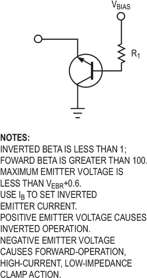

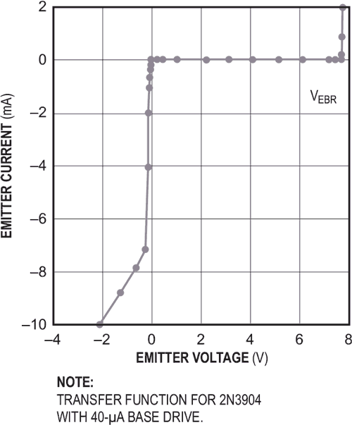

Figure 1 shows the bipolar-inverted-clamp circuit and a typical transfer function. The collector connects to ground or any other desired reference voltage. A fixed current drives the base. In the absence of any external drive, the emitter voltage is near zero. Driving the emitter with an external voltage produces the transfer function in Figure 1.

Figure 1. The bipolar inverted clamp (a) has an excellent rectification characteristic
(b) because of the 2N3904’s large forward-beta-to-reverse-beta ratio.
The circuit achieves this excellent rectification characteristic by using a transistor with a large forward-beta- to-reverse-beta ratio. Many of these transistors are still available. The 2N3904 provides excellent characteristics at a low cost. The reverse beta of the 2N3904 is only 0.25, so that for positive voltage on the emitter, and, with 40 µA of base drive, the emitter, current is around 10 µA. This current is sufficient in most level-detector applications for which the ac input amplitude changes slowly.

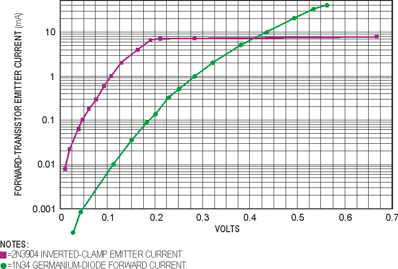

Figure 2. A logarithmic scale of the 2N3904’s forward-transistor emitter current and the forward
current of the 1N34 show the impressive response of the 2N3904 at small voltages.
The emitter current at even small negative voltages is much greater than in the inverted region because the forward beta of the 2N3904 is greater than 100. Impedance is low up to the beta-limited forward current, at which point the impedance increases to approximately the value of R1/beta. Figure 2 shows the forward-transistor emitter current of the 2N3904 and the forward current of the 1N34 germanium point-contact diode. The logarithmic current scale shows the impressive response of the 2N3904 at small voltages.

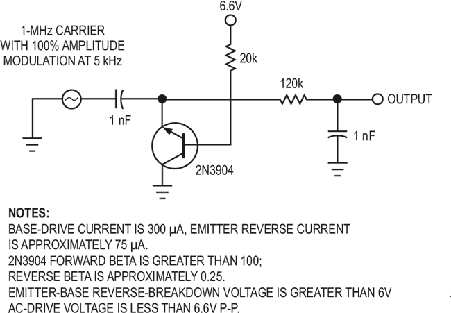

Figure 4. Using the inverted clamp as an AM demodulator requires a base current
of 300 µA to track the RF-modulation envelope.
The transfer function in Figure 1 also shows a sudden increase in inverted current at approximately 7.6 V, which occurs at the reverse breakdown voltage for the emitter-to-base junction. Because you know in this case that the base is near 0.6 V, the breakdown voltage for the tested part is near 7 V. Production circuits would have an input limit of 6.6 V p-p because of the minimum specified breakdown voltage of 6 V. Note that, for a small production, such as for test equipment, it is practical to select individual transistors to slightly increase the dynamic range. A 6 V p-p input dynamic range is sufficient in many applications.

The RF demodulator in Figure 4 has a base drive current of 300 µA. This current is necessary to track the RF-modulation envelope and depends on the size of the input capacitor, modulation frequency, and maximum signal amplitude. The reverse current, which is IBASE times the reverse beta, must be large enough to discharge the input capacitor at the highest modulation frequency and amplitude to prevent distortion in the output waveform. Figure 5 shows the running demodulator with the upper trace at the emitter node and the lower trace at the output.
