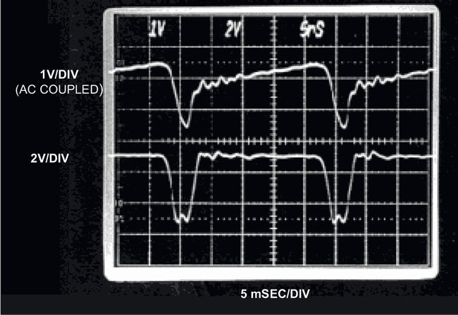

Applying a positive input voltage causes IC1's output to go negative and alter Q1's bias. In turn, Q1's collector current produces a voltage ramp on C1 (upper trace in Figure 2). The ramp's amplitude increases until Schmitt trigger inverter IC2A's output (lower trace in Figure 2) goes low, discharging C1 through Q2 (connected as a low-leakage diode). Discharging C1 resets IC2A's output to its high state, and the ramp-and-reset action continues.

Figure 2. On a 700-MHz real-time oscilloscope, the oscillator-core waveforms at a 40-MHz
operating frequency show the ramp-and-reset waveform at Q1’s collector
(upper trace) and Q2’s emitter (lower trace).

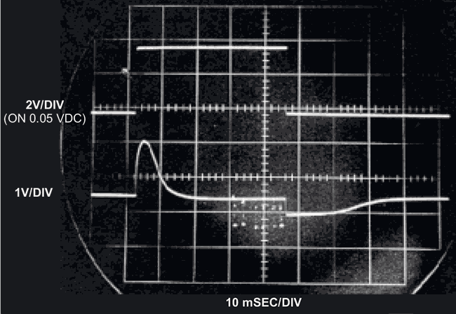

The 0.22-µF capacitor, C7, averages the difference signal between the input-derived current and the charge pump's output and applies the smoothed dc signal to amplifier IC1, which in turn controls the bias applied to Q1 and thus the circuit's operating point. As noted, the circuit's closed-loop-servo action reduces the oscillator's drift and enhances its high linearity. A 1-µF Wima MKS-2 metallized-film-construction capacitor, C8, compensates the servo loop's frequency response and ensures stability. Figure 3 illustrates the loop's well-behaved response (lower trace) to an input-voltage step (upper trace).

Figure 3. In response to an input-voltage step (upper trace), the voltage at the circuit’s
summing junction shows a 30-msec settling time.

The circuit's 100-MHz full-scale upper frequency limit forces stringent restrictions on the oscillator core's cycle time, and only 10 nsec is available for a complete ramp-and-reset sequence. The reset interval imposes an ultimate speed limit on the circuit, but the upper trace in Figure 2 shows a 6-nsec reset interval that falls comfortably within the 10-nsec limit. A path from the circuit's input to the charge pump's output allows for correction of small nonlinearities due to residual charge injection. This input-derived correction is effective because the charge injection's effects vary directly with the oscillation frequency, which the input voltage determines.
