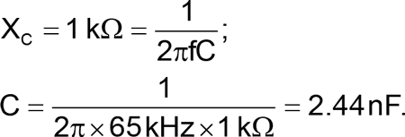

The op-amp’s slew rate limits the frequency of this application. The comparator output must maintain a square shape, so the minimum period can be defined using the total excursion and a factor of 10:
e.g.,
At this maximum frequency, the adder output current through R9 & C1 must be drivable by the op-amp. If necessary, calculate the RC impedance and C1 value – in this example, to meet 2 kΩ total: R9 = 1 kΩ, XC = 1 kΩ.
