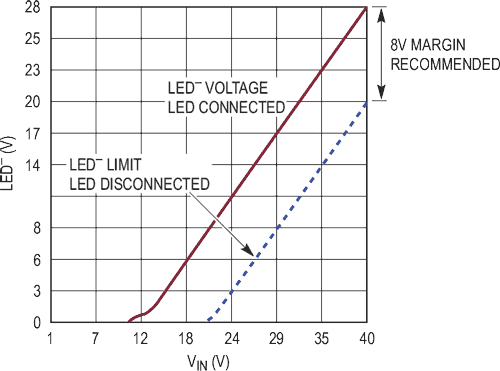

Figure 3. DC Measurement of LED and LEDLimit.
Figure 3 shows measurement of the LED voltage and the LED open-circuit limit as VIN is swept from 0 V to 40 V using the circuit of Figure 4. The voltage limit tracks the input well over the full operating range.

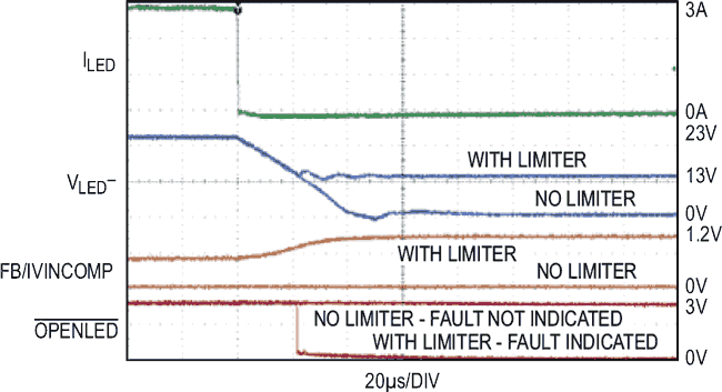

Figure 5 compares the transient response for an open-circuit condition with and without the use of the output limit circuit: VIN = 36 V, ILED = 3 A, four series LEDs.
3A, 1MHz Buck Mode LED Driver with Integrated Voltage Limiting
Figure 5. Open-Circuit Fault with and without Limiter.
As you can see, an open-circuit fault without the limiter causes LED to be pulled from its 23 V nominal value all the way to ground, resulting in nearly the full 36 V input potential from LED+ to LED.
With the limiter, however, the output voltage is quickly limited to a more reasonable value. The connection of FB to IVINCOMP allows the fault to be indicated on the OPENLED pin.

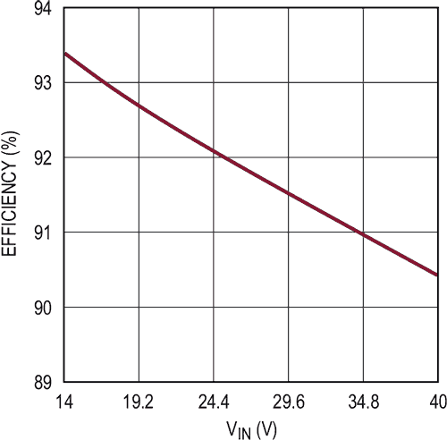

Figure 6. Efficiency vs Input Voltage.
The overall efficiency for this 40 W solution is greater than 92% at 24 V input voltage, and greater than 90% over the entire input voltage range of 14 V to 40 V (Figure 6). When using any output limiting technique, remember to leave some margin between the limit voltage and the normal operating voltage.
