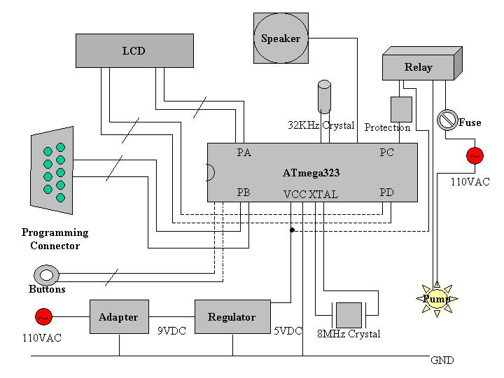

The following diagram shows the system schematic.
It contains the several major blocks:
  • ATmega 323 is the CPU of the system.
  • 5 VDC power supplier: an adaptor first transforms 110 VAC 60 Hz into 9 VDC; then a regulator keeps VCC stable at 5 VDC.
  • A crystal of 32KHz is used to provide a real-time clock.
  • A crystal of 8MHz is for the CPU frequency.
  • A block of circuit is built for programming so that the executable code can be downloaded from a computer to the system via a serial RS-232 port.
  • A LCD is used to display the time and system states.
  • A speaker is used for alarming and making sounds.
  • Push buttons allow a user to change the system states.
  • A relay is used to control the AC of the water pump with a DC signal from the processor.
  • A block of circuit is used to protect the processor since a high voltage introduced from the relay can damage the processor.

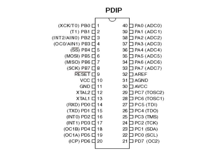

The AVR processor used in this project is an ATmega323. It has two 8-bit Timer/Counters and one 16-bit Timer/Counter. Meanwhile, it supports the real-time counter. These features satisfy the system's demands. More detailed information can be founded in data sheets at Atmel. The following picture shows the pin configurations of the ATmega323.

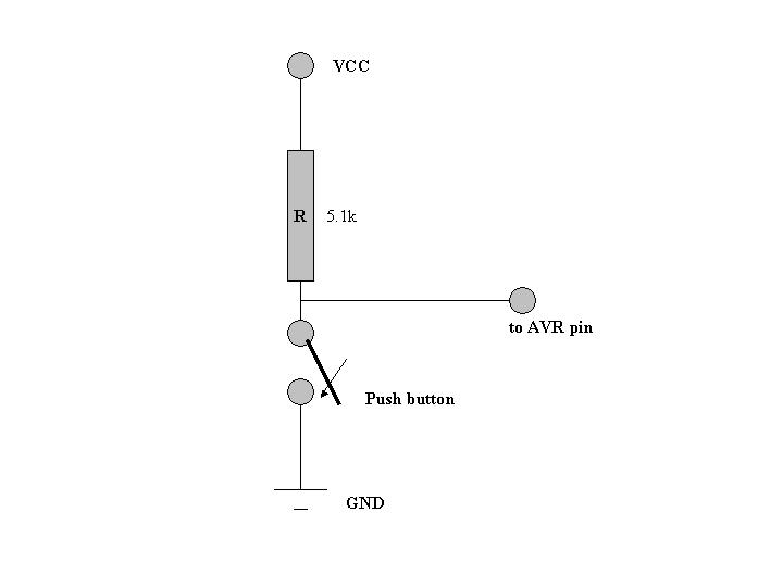

The following diagram shows how push buttons work. When the button is pressed, the output signal is connected to GND. When it is released, the output is connected to VCC. Thus, it simulates push buttons in AVR STK500 kit. Push buttons are nominally open.

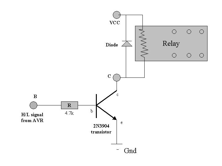

In the system schematic as shown previously, there is an additional circuit for the relay to protect the AVR’s pins from being damaged. As we know, U=LdI/dt. There could be as large as 100 volts introduced from coils in the relay when the current flow in the coils are suddenly stopped or allowed. This high voltage can easily break through the AVR ports. In order to protect the AVR, the following circuit is used to limit the voltage applied on the AVR pins.
With this circuit, about 5 volts will be applied if the input control signal at B is high, which is large enough to trigger the relay
With this circuit, about 5 volts will be applied if the input control signal at B is high, which is large enough to trigger the relay.

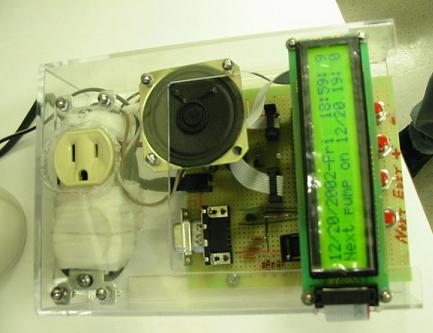

User Interface
The system provides a variety of UI functions. It has a pump, a LCD, a speaker and five push buttons.
The pump irrigates plants, which is our goal. Constrained by the water pump, the system uses a semi-volume control method by pumping for a specified amount of time. Water flow can be manually off-line adjusted by rotating a plastic valve in the pump. So please do some check and make sure that the pump supplies a desired amount of water in the specified time duration, before you leave the system to work.
