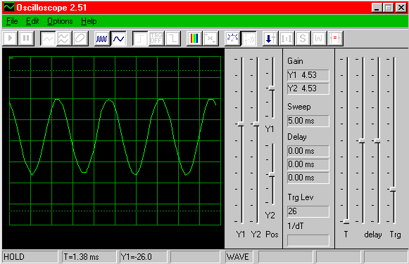

The two 100k preset resistors adjust the purity of the sine wave. If adjusted correctly, then the distortion amounts to less than 1 %. The output waveform ideally needs to be monitored with an oscilloscope, but most people reading this will not have access to one. There is however, an easy alternative:- Winscope. This piece of software uses your soundcard and turns your computer into an oscilloscope. It even has storage facility and a spectrum analyser, however it will only work up to around 20 KHz or so. Needless to say, this is more than adequate for this circuit, as alignment on any range automatically aligns other ranges as well. Winscope is available here. Winscope is freeware and designed by Konstantin Zeldovich. After downloading, read the manual supplied with winscope and make up a lead to your soundcard. My soundcard is a soundblaster with a stereo line input, i made up a lead with both left and right inputs connected together. Connect the lead to the high output of the function genereator, set the output level to high, shape to sine, and use the 1k to 10k range, (22 nF capacitor). A waveform should be displayed, see the Figure 1 below:
waveform
Figure 1.
Here an undistorted sine wave is being displayed. The display on winscope may flicker, this is normal as it uses your soundcard to take samples of the input waveform. The "hold" button on winscope will display a steady waveform.

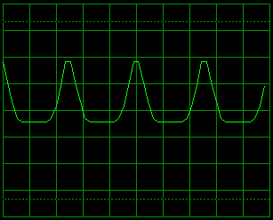

First adjust the 100k preset connected to Pin 1 of the 8038. An incorrect setting will look similar to the waveform below:

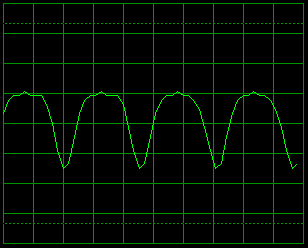

Adjust the preset so that the top of the sine wave has a nicely rounded peak. Then adjust the other preset, again an incorrectly adjusted waveform is shown below:
The two presets work together, so adjusting one affects the other. A little is all that's needed. When your waveform is asjusted and looks similar to Figure 1 press the FFT button on winscope. This will preform a fast fourier transform and the displayed output will be a spectrogram of the input. For a pure sine wave, only one signal is present, the fundamental frequency, no harmonics will be present and so a spectrogram for a pure sine should contain a single spike, see Figure 2 below:

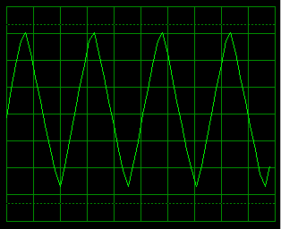

Once alignment of the sine wave is complete, the other wave shapes will also be set up correctly. Below is a picture of the triangle waveform generated from my circuit:
