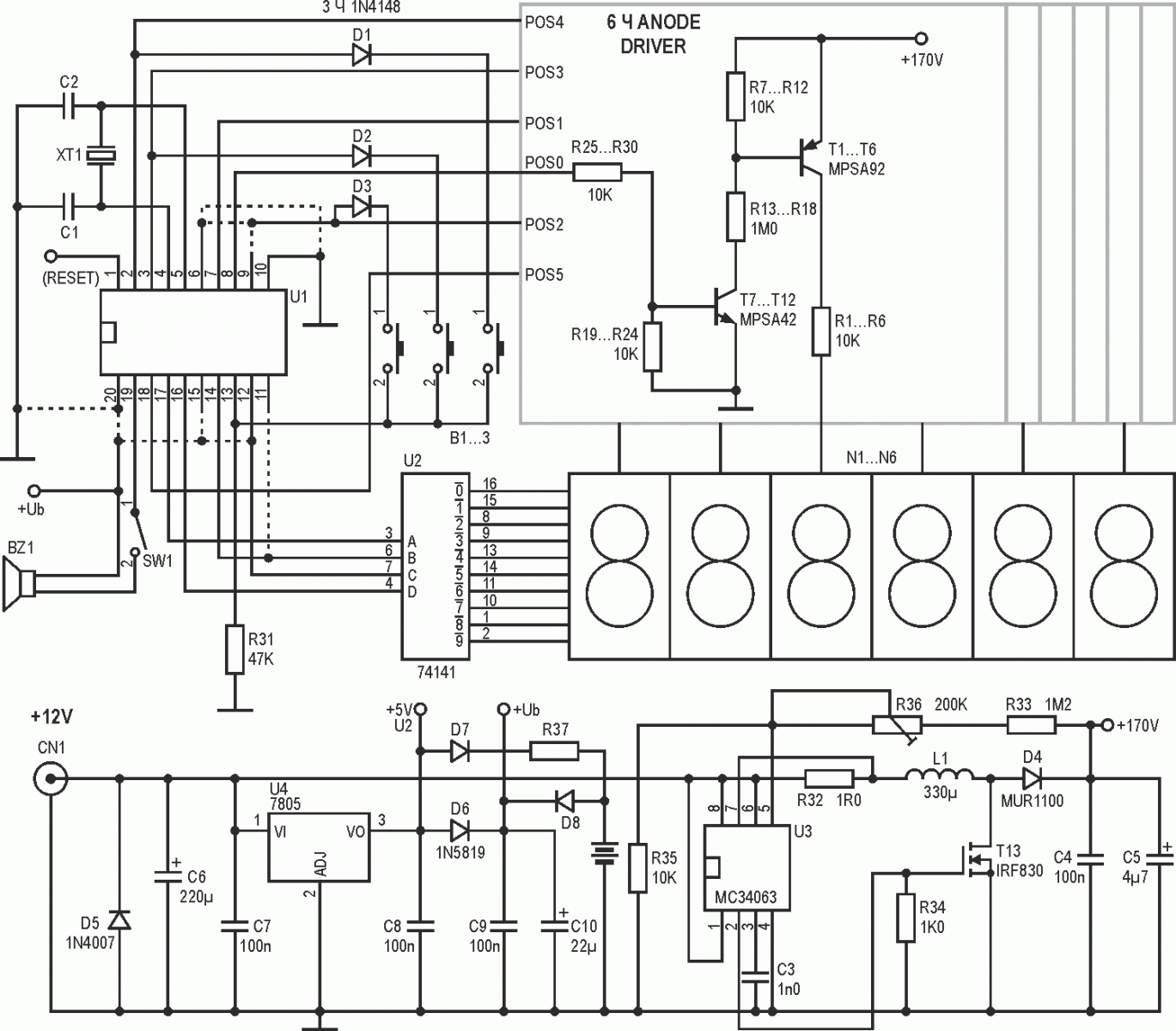

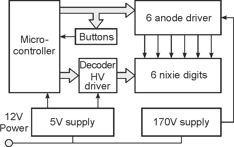

The multiplex mode is natural solution for device with 6 digit display.
Most of blocks in the block diagram are clear. Somewhat special is converter TTL/high voltage for nixies. Anode drivers are based on high voltage NPN and PNP transistors. I took the driver here.
How to make your own electronic clock in retro style
TTL IC 74141 ensures BCD decoder and high voltage driver for individual digits. Perhaps it will be difficult to come by 1 piece of it (I don't know if 74141 is produced still). But if you discovered nixies, 74141 could be near :-). In time of TTL logic fame the 74141 was almost exclusive alternative. So try to find one.
Nixie need voltage about 170 V. It would be useless to design special circuit for voltage converter. There is a lot of IC for step-up (boost) converters. I selected low cost and widely available MC34063. The converter circuit is almost copied from data sheet. Just only power switch is strengthened by T13. Internal switch is not suitable for such high voltage. I use choke coil as inductor for converter. Diameter is 8 mm and length is 10 mm - see the picture.
Efficiency of the converter is good and output voltage is relatively safe. The output voltage decreased to 60 V at output current 5 mA. R32 is current-sense resistor.
Power supply for logic is linear regulator U4. There is a place for reserve accumulator (3.6 V - NiMH or NiCd) in the schematic and on the board. Diodes D7 and D8 are Schottky type and R37 must limit charge current in compliance with accumulator. Accumulator, D7, D8 and R37 are not necessary if your clock will serve just for fun.
The final schematic diagram is here:
Buttons for clock setting are connected via diodes. If logic "1" is present at exact position appropriate button is tested. The small piezoelectric buzzer is connected to microcontroller output as a bonus function. Use small switch for shutting up this disgusting morning alarm. The hammer will serve as well, but it is final solution :-).

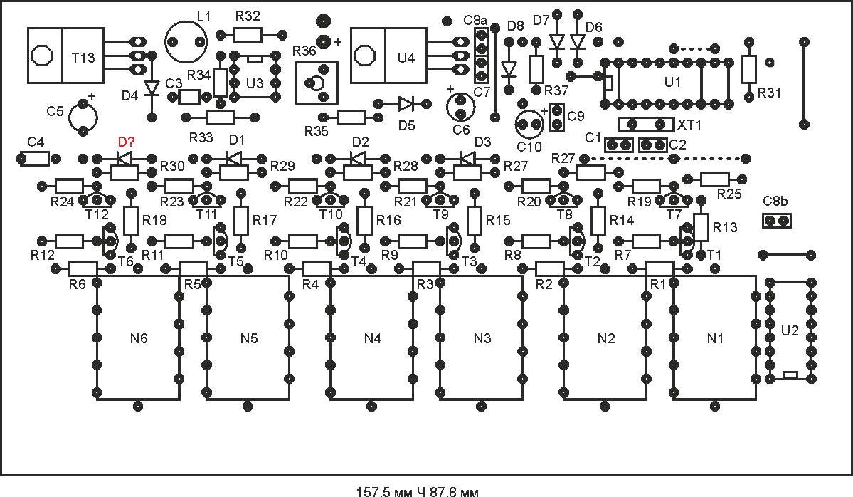

The component bill is here, PCB is here…

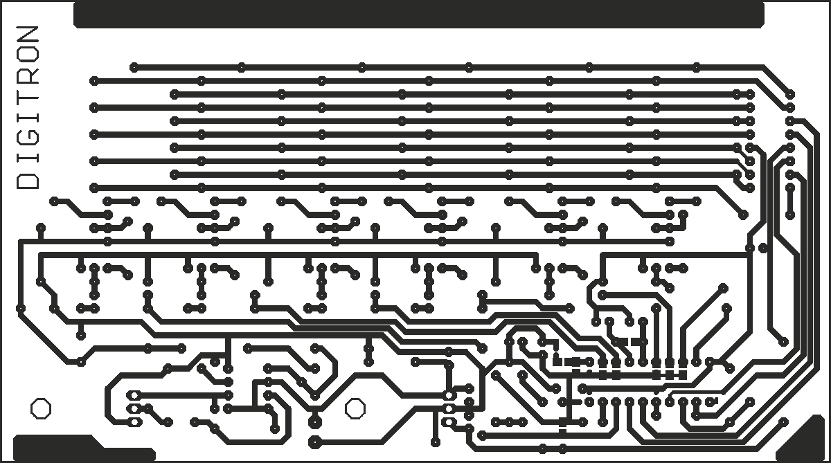

… and circuit layout is here.
Click on the picture for 600 dpi picture (save it and print).

Start component mounting and setting in operation with power supply. Mount U4 and components around. Check voltage 5 V for U2 and cca 4.6 V for U1. The next step is high voltage converter mounting. Use R36 to set the output voltage to 170 V. If the range of trimmer is insufficient change the value of R33 slightly. Insert U2, transistors and resistors for anode drivers and nixies. Connect U2 inputs to GND and in sequence separately connect R25 - R30 to +Ub. The nixie in this position would light. As the last HW test connect pin 19 of U1 to GND - buzzer will beep.
You can find source and compiled program for microcontroller in the appropriate ZIP file. After microcontroller is programmed check carefully every pin of U1 position and fill up needed wire jumpers and tin junctions. See the pictures for microcontrollers above. If the microcontroller is correctly programmed and connected the clock would start to operate. You can set the time and alarm. Warning! There is one more button position on PCB (spare button for future expansion :-).
