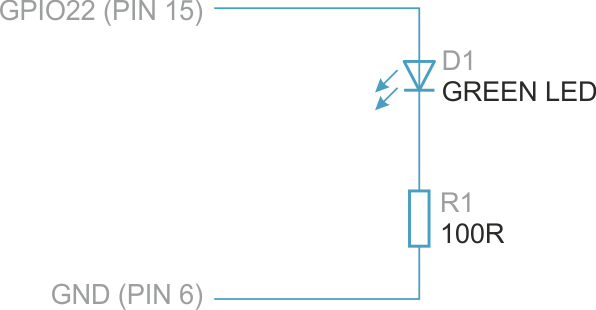

Figure 4. Schematic Diagram: Connecting LED to
Raspberry Pi GPIO 22.
A bread board, a single resistor and an LED were connected up to the Raspberry Pi. The GND (also known as 0 V) connection was taken from pin 6 on the Raspberry Pi header, and the GPIO pin used was GPIO22 (see the diagram earlier) which is pin 15. Any GPIO pin could be used; they are marked in pink on the earlier diagram. Another way of representing this is shown in the schematic below.
Once you’ve connected up the LED, a program or script can be written to control it. The choice of language is up to you. One (popular) example is Python; here is some code that will light up the LED.

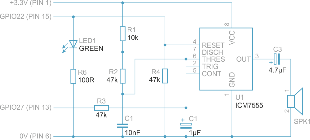

Another Output Example: Tone Generator
A more interesting example than an LED is to use a couple of GPIO pins to control a tone generator circuit. The Raspberry Pi has a headphone connector for audio but sometimes just a simple tone or alarm is needed to signal events (such as for an alarm clock project).
Raspberry Pi GPIO Explained
Figure 5. Simple Tone Generator connected to two RPi GPIO.
The photo below (Figure 5, 6) shows a very simple single integrated circuit (IC) project that can generate various sounds. By adjusting resistor and capacitor values, different tones and sounds could be created.
Figure 6. Tone Generator circuit on bread board.
The circuit connects to two outputs from the Raspberry Pi. One output is used to switch the tone on or off, and the other is used to alternate between two tones. One of the capacitors in the circuit is used to create a sweeping tone transition when tones are alternated. The circuit diagram is shown below; it uses an ICM7555 timer integrated circuit. GPIO22 was used to switch the tone on and off, and GPIO27 modifies the tone. C1, R1 and R2 can be adjusted to select the desired tones.

Note that the circuit uses the 3.3 V supply (pin 1) available from the Raspberry Pi. Only use this supply if you know your circuit doesn’t consume much power. More than a few tens of milliamps of current consumption would require your own external power supply. Another approach would be to build a 5 V to 3.3 V regulator circuit and connect it to the 5 V supply available on pin 2 from the Raspberry Pi.

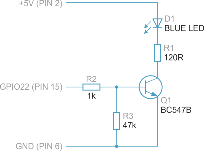

Any Color Low Power LED
Blue and white LEDs may require a voltage higher than 3.3 V. The easiest way to control a single LED is to use a transistor circuit to switch the 5 V supply rail (Figure 7). The value of R1 should be increased if using an LED of any color other than blue or white. In general consult the LED data sheet. Any NPN transistor should work for this circuit.
Figure 7. Control LED using a transistor.

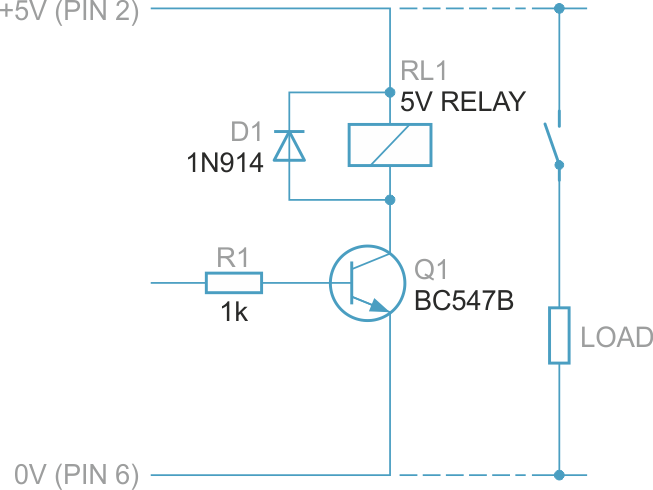

Higher Power AC or DC Devices (but not mains!)
A relay is useful for this scenario. Virtually any NPN transistor can be used (Figure 8). Popular devices include BC547B, 2N3904 and BC549. If the connected device can function from 5V DC then the Raspberry Pi's 5 V connection on pin 2 of the 40-pin header could be connected to the relay switch as long as the required current is not too high (use 100 mA as a very conservative guideline) otherwise the relay switch can be connected to an external supply (take care it doesn't accidentally short to the 5 V supply or any other connection on the Raspberry Pi – keep it totally isolated). Check the relay datasheet to confirm that it is suitable for your needs.
Figure 8. To control High Power AC or DС devices use a relay with transistor.
A small relay with pins convenient for breadboard layout is Finder 32.21.7.005.2000 and it can switch up to 6 A. Note that just because a relay is rated for (say) 250 V does not mean it can be used for this. Breadboards and stripboards are designed for far lower voltages. Even with a custom PCB the project should not be used at mains voltages because there are legal requirements for conductor spacing, temperature, types of enclosure material, connection type, conductor clamping method and so on. It is easy to create a product that will fail and cause personal injury or an electrical fire or harm others at some point in time.

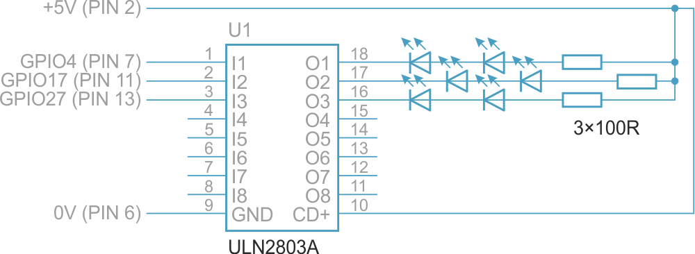

Multiple Relays, LEDs or Devices that require less than 200 mA Current at 12 V
The ancient (>25 years in production!) yet useful ULN2803A integrated circuit can be employed for this scenario (Figure 10). Several hundred milliamps can be supplied by each output pin (there are 8 of them).
Figure 10. ULN2803 can be used for control multiple relays, LEDs or Devices
that require less than 200mA Current at 12 V.
