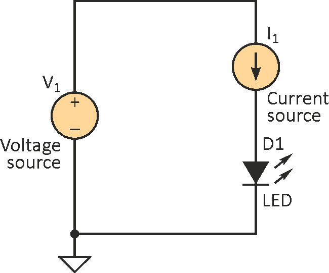

Many applications for LED illumination require wide dimming ratios, which can be easily done using an adjustable current source (Fig. 1).
Hybrid Switching/Linear Method Yields LED-Current Controller with Wide Dimming Ratio
Figure 1. LEDs are current-driven, rather than voltage-driven,
devices, and their output intensity is related to the
current level – but not linearly.
The current source can be adjusted over a large LED current range using several different techniques. The primary problem with this technique is that the power dissipation can be quite high. Voltage source V1 has to be high enough to accommodate the largest LED voltage drop and the headroom required by the current source. LED manufacturers typically specify a maximum voltage that’s higher than the average value, forcing the designer to use a higher-than-necessary input voltage. Applications that use multiple LEDs in series multiply the voltage-tolerance issue.
In addition, applications may not have access to a voltage of the optimum value to drive the LED string, forcing the designer to incorporate another supply to bring the input voltage to a usable level. This adds additional circuitry and power dissipation of its own.

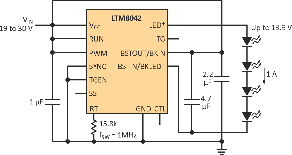

This issue has been addressed by making a switching power supply have a constant-current output (rather than a constant-voltage output), and making this current adjustable to implement dimming. The concept is shown in Figure 2 using the LTM8042.
Figure 2. A power supply designed for externally adjustable constant-current output,
here done with the LTM8042, meets the drive needs of LEDs.

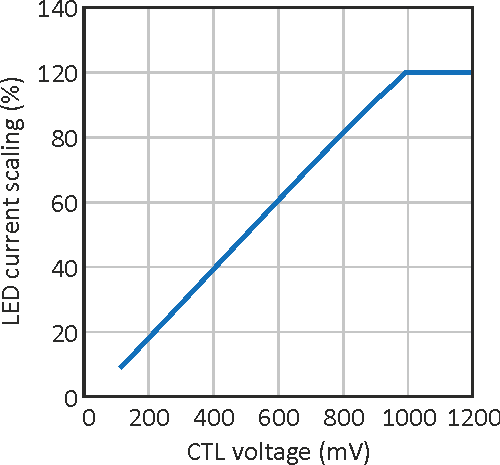

By varying the voltage on the CTL pin from 100 mV to 1 V, the LED current can be scaled over a 10:1 range (Fig. 3).
Figure 3. When the CTL pin on the LTM8042 is varied between 100 mV and
1 V, the LED current is then scaled over a 10:1 range.
This limitation in dimming ratio comes primarily from the difficulty in scaling the current-sense signal in the pulse-width-modulation (PWM) section of the switching regulator to very low levels. The dimming ratio can be extended by using the PWM signal to the LED to pulse it on and off. If this pulsing can be done at a high-enough rate – typically a few hundred hertz – the pulsing is not visible to the human eye. With this technique, the dimming ratio can be extended to 3000:1 (Fig. 4).
