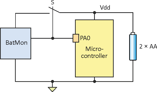

Instead, this circuit was developed to indicate the state of the batteries, using some standard discrete components. The battery monitor needed to:
  • Use only one pin of microcontroller (important when using low pin-count device).
  • Have very low current drain when in Idle state.
  • Use the same pin to switch from Active to Idle state and to read the state.
Figure 1 shows how only one pin – PA0 – of the microcontroller is used to implement the different functions for the battery-monitor (BattMon) circuit, driving switch S from Idle to Active mode, reading the state of the battery provided from BattMon, and going back from Active state to Idle state.
Microcontroller Battery Monitor Circuit Needs Only One Pin
Figure 1. The basic concept of the battery monitor shows the relationship
among functions and that only one pin of the microcontroller
is used to implement the circuit.
The complete circuit (Fig. 2) is powered by two AA batteries. Every n seconds (or even hours), the microcontroller decides to see if the battery level is over or under 2.2 V. When the microcontroller is not looking to check the battery voltage, it sets PA0 to high level, so Q5 is off. This assures that the current of the BattMon circuit (the blue box of Fig. 1) is very low, which is very important for a portable device. Measured current in this state is approximately 4 µA.
