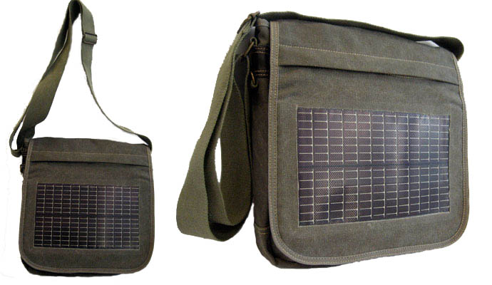

Before cutting a hole in your bag, a few words on our design: We wanted the solar panel integrated as seamless as possible, it should look as the bag was designed with a solar panel in mind. We decided to laminate the solar panel to the fabric of the bag, no stitches visible.
We begin by marking the bag where the hole of the size of the active area of the solar panel will be (you will see easily what we mean with the active area when you have the solar panel in front of you) and cut the hole out (see images 1 to 3).

Slide the solar panel through the hole into the bag and don’t forget to guide the power cable at the same time inside the bag (see images 12 and 13). Take off the protective paper of the double sided tape one by one and place the solar panel to match the hole you cut out earlier. Apply pressure to ensure the panel stays in place first. Then use a piece of cloth like linen and use again your fingernails to force the fabric on to the glue of the tape. The linen will avoid rub marks from you fingernail on the bags fabric (see image 11).
You are almost done. Check if the edges of the cutout around the solar panel are clean and no loose treats are there. Cut them off if needed. Apply textile glue around the edge of the solar panel cutout. The textile glue is used for seaming the edges of the fabric and can withstands wear, tear and washing - perfect for our design.
