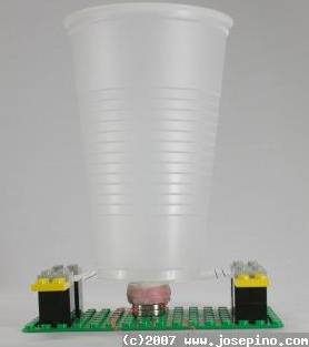

    I did a modification to my homemade speaker and it improved the volume of the sound. A simple disposable [plastic] cup amplifies the sound mechanically. The sound is amplified because the resonance of the plastic cup.
    homemade speaker Once the "Speaker" is assembled, cut a hole on the business card. (see next photo)
    bottom of speaker Glue the coil to the bottom of the cup instead of the business card.
    How To Make a Homemade Speaker Glue the plastic cup to the business card and that's it! Now it looks like a real speaker, a home-made speaker, just built from scratch.
