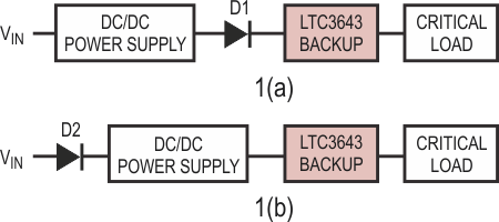

The LTC3643 easily fits backup solutions for 5 V and 12 V rails, but a 3.3 V rail solution requires extra care. The minimum operating voltage of the LTC3643 is 3 V, relatively close to the nominal 3.3 V input voltage level. This is too tight when a blocking diode is used to decouple the backup voltage source from noncritical circuitry as shown in Figure 1a. If D1 is a Shottky diode, its forward voltage drop – as a function of load current and temperature – can reach 0.4 V to 0.5 V, enough to place the voltage at the LTC3643 VIN pin below the 3 V minimum. As a result, the backup supply circuit may not start up.
One possible solution is to move the diode to the input of the supplying DC/DC converter, D2, as shown in Figure 1b. Unfortunately, in this scenario, noncritical loads connected to the upstream DC/DC supply can draw power from the backup supply, leaving less energy for critical loads.

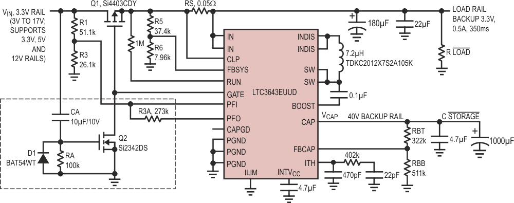

Figure 2 shows a solution to producing a 3.3 V backup supply that reserves energy for critical loads using a blocking MOSFET. The blocking diode shown in Figure 1 is replaced by Q1, a low gate threshold voltage power P-channel MOSFET.

Figure 2. Enhanced Schematic of the LTC3643 Solution for a 3.3 V Rail.
The key to operating the backup supply in a 3.3 V environment is the addition of the series RA-CA circuit. At start-up, as the input voltage rises, the current through the capacitor CA is governed by the equation
This current generates a potential across RA, enough to enhance Q2, a low gate threshold voltage small signal N-channel MOSFET. As Q2 turns on, it pulls the gate of the Q1 to ground, providing an extremely low resistance path from the input voltage to the supply pins VIN of LTC3643. Once 3.3 V is applied to the converter, it starts up, pulling down both the gate of Q1 and the PFO pin, and it starts charging the storage capacitor.
As the 3.3 V rail reaches steady state, the IC current reduces to the point where the voltage across RA falls below the Q2 gate threshold level and Q2 turns off, no longer affecting the functionality of the backup converter. Also, the PFO pin grounds R3A, resetting the PFI pin power fail voltage level to the minimum 3 V, to ensure that the converter remains operational when the input voltage source is disconnected.

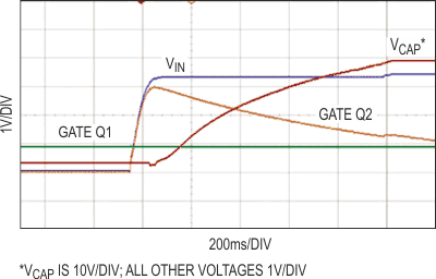

The waveforms in Figure 3 show results as the 3.3 V rail starts up. As the input voltage rises, so does the gate of Q2, pulling the gate of Q1 low. Q1 remains enhanced, allowing the full 3.3 V to reach the LTC3643, bypassing the Q1 body diode. Eventually the gate of Q2 voltage drops below the threshold level and Q2 turns off – by this time the LTC3643 is fully operational and takes control over the gate of Q1.

The versatility of the LTC3643 is on display here: specifically its ability to limit the charging current of the boost converter used to charge the storage capacitor in cases where total current must be minimized, such as when there are long lines or high impedance voltage sources. The boost current can be set relatively low to minimize the effect of charging current on the input voltage drop. This is particularly important for 3.3 V rails. In Figure 2 the resistor, RS, 0.05 Ω, sets a limit of 0.5 A (10.5 A load) for the boost converter charging current (maximum possible set limit is 2 A); the rest is delivered to the load.

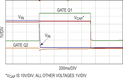

Figure 4. Waveforms of 3.3 V Rail for Power-Down.
Figure 4 shows the waveforms when the 3.3 V rail is lost. As the input voltage falls, the voltage at the gate of Q2 remains unchanged, close to ground, and Q2 remains off. In contrast, the voltage at the gate of Q1 rises sharply to 3.3 V. This turns Q1 off, with the body diode of Q1 acting as a blocking diode, decoupling load from the input. At this point the backup supply takes over, with the LTC3643 supplying 3.3 V to the critical load by discharging a storage capacitor.
