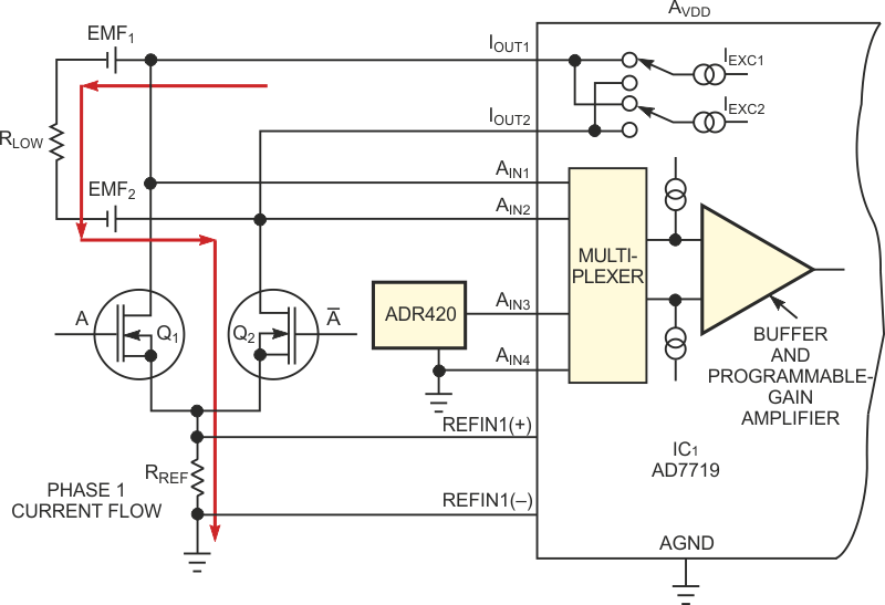

When you try to measure small voltages or low impedances, thermal EMFs (electromagnetic fields) are likely to cause errors in the readings. A standard way that digital-multimeter manufacturers deal with the problem is to initially take one reading and then to reverse the excitation and take a second reading. Reversing the current excitation through a low-value resistor or thermocouple junction reverses the polarity of the desired signal but does not affect the polarity of the unwanted EMF voltages. Subsequently averaging the two readings eliminates the thermoelectric EMFs from the final result (Reference 1). Figure 1 shows IC1, an AD7719 ADC measuring a low-value resistor, RLOW. The diagram also shows two thermoelectric EMFs, EMF1 and EMF2, representing summations of all the thermoelectric EMFs on the way from and to the ADC and the resistor. These EMFs would normally cause an error if you were to take a single measurement of RLOW.
Eliminate thermoelectric EMF in low-ohm measurements
Figure 1. In this configuration, the excitation current flows in RLOW from top to bottom.

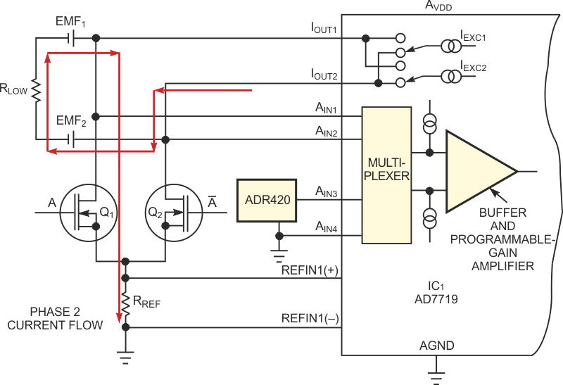

However, you can program each of the AD7719's two current sources, IEXC1 and IEXC2, to appear at either of the package pins, IOUT1 and IOUT2. This feature allows you to reverse the excitation current through the low-value resistor. You can thus take two measurements and eliminate the effects of EMF1 and EMF2. To increase the excitation current and thereby increase the measurement sensitivity, the two internal 200-µA excitation currents appear in parallel with each other. Thus, a single 400-µA current source makes up the excitation current, IEXC, in this design. Transistors Q1 and Q2 steer the excitation current through the reference resistor, RREF, to ensure that the same polarity reference voltage always appears, regardless of the excitation-current direction. Port pins P1 and P2 (not shown) of the AD7719 drive the transistors in antiphase mode. A value of 6.8 kΩ for RREF is suitable and ensures a typical ratiometric reference voltage of 2.5 V.

Figure 1 and Figure 2 show the current flow in each phase of a measurement. During Phase 1, the excitation current flows out of IOUT1, through RLOW, and through RREF via Q2 to ground. During Phase 2, the excitation current flows from IOUT2, through RLOW, and through RREF via Q1 to ground. During Phase 1,
VDIFF(PHASE1) = VAIN1 – VAIN2 = VEMF1 – VEMF2 + IEXC×RLOW.
You now switch the current sources. During Phase 2,
VDIFF(PHASE2) = VAIN1 – VAIN2 = VEMF1 – VEMF2 – IEXC×RLOW.
You now combine the two measurements in software to cancel the thermoelectric EMFs:
VDIFF = VDIFF(PHASE1) – VDIFF(PHASE2) = IEXC×RLOW.
Finally, you need to turn this ratiometric measurement into an absolute one. You achieve this result by measuring a known voltage using the "unknown" ratiometric reference voltage. Taking a reading of this known voltage but with an unknown reference allows you to infer the unknown reference value and, hence, the absolute value of VDIFF on pins AIN1 and AIN2. An absolute voltage reference, such as an ADR420, supplying 2.048 V output, provides the known voltage. It connects to the second pair of differential inputs, AIN3 and AIN4, and into the main 24-bit ADC channel.
