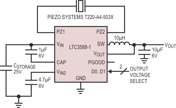

The LTC3588-1 shown in Figure 1 is a complete energy harvesting solution optimized for high impedance sources such as piezoelectric transducers. It contains a low loss full wave bridge rectifier and a high efficiency synchronous buck converter, which transfer energy from an input storage device to an output at a regulated voltage capable of supporting loads up to 100 mA. The LTC3588-1 is available in 10-lead MSE and 3 mm × 3 mm DFN packages.

The LTC3588-1 requires the output voltage of the transducer to be above the undervoltage lockout rising threshold limit for the specific output voltage set at the D0 and D1 input pins. For maximum energy transfer, the energy transducer must have an open circuit voltage of twice the input operating voltage and a short-circuit current of twice the input current required. These requirements must be met at the minimum excitation level of the source to achieve continuous output power.
Piezoelectric Transducer Application
Figure 3 shows a piezoelectric system that, when placed in an air stream, produces 100 μW of power at 3.3 V. The deflection of the piezoelectric element is 0.5 cm at a frequency of 50 Hz.
Energy Harvester Produces Power from Local Environment, Eliminating Batteries in Wireless Sensors
Figure 3. Piezoelectric Energy Harvester.
